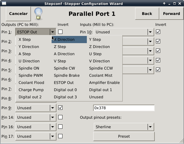

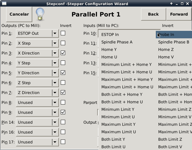

Hi guys, I have an older PC that had the Debian Wheelzy iso with linuxcnc 2.7.14, I updated the repository link in Synaptic and then updated Linuxcnc to 2.8.4, but the "tandem items" do not appear when I go configure the parallel port pins.
On one of the axes I have two motors and I want to do square homing as done in this video , but I don't have the "tandem option" to select the two motors and sensors which are on the same axis.
I'm not using a mesa card, I'm using a PC with a parallel port, how can I solve it? Because from what I researched on the forum, from version 2.8.* of Linuxcnc there should already be this 'function' with tandem items...
Thanks.
Thanks.

Hi JT, how are you? Here on my 2.9.2 it appears, I made a short video showing it, attached to the post.I have LinuxCNC 2.9.2 here and have never seen anything called "tandem items" in the Stepconf tool.JT Hi JT, how are you? Here in mine, I made a short video showing it, attached to the post.
