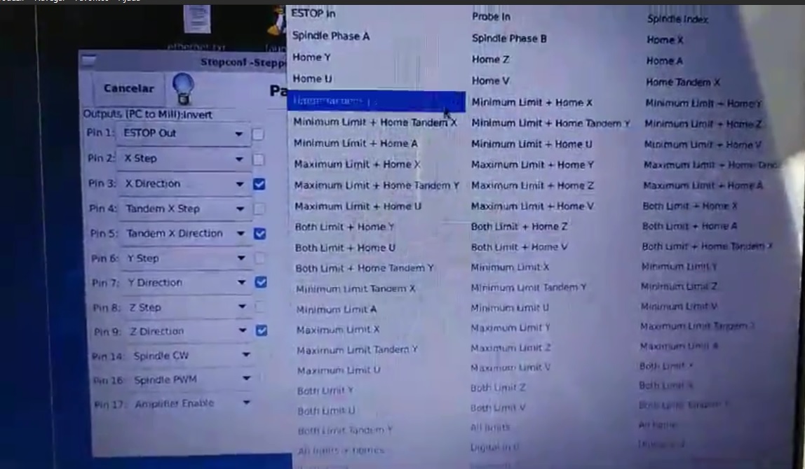

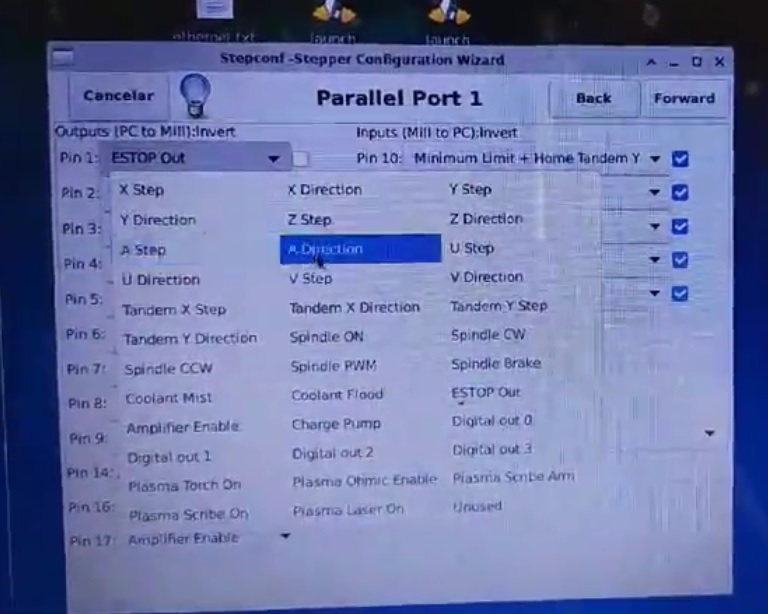

Linuxcnc 2.8.4 does not show tandem items.

Of course, I attached two prints...
I have LinuxCNC 2.9.2 here and have never seen anything called "tandem items" in the Stepconf tool.JT Hi JT, how are you? Here in mine, I made a short video showing it, attached to the post.
Hi JT, how are you? Here on my 2.9.2 it appears, I made a short video showing it, attached to the post.
Hmm, I can't seem to open a .rar file here perhaps a screen shot?
JT

I see that now, thanks for clarifying that for me... looks like someone has been working on the Stepconf tool.

Looks like Phil added tandem joints about 3 years ago to the 2.9 branch.

Hmmm interesting, so if I didn't understand it wrong, the 'tandem function' is only really implemented in stepconf and in the files generated by it from version 2.9.* onwards....Looks like Phil added tandem joints about 3 years ago to the 2.9 branch.

That's correct, I changed to the 2.8 branch to see and the tandem function is not in that branch.

Well, as there is no way to update the Linuxcnc version, is there any other way to manually configure the INI and Hal to square the gantry using two motors and two sensors on the same axis?

Yes, you just need to set the home sequence to a negative number.Well, as there is no way to update the Linuxcnc version, is there any other way to manually configure the INI and Hal to square the gantry using two motors and two sensors on the same axis?

Gantry homing has been a part of LinuxCNC since 2.8 IIRC. I would read the docs I linked for better information.
