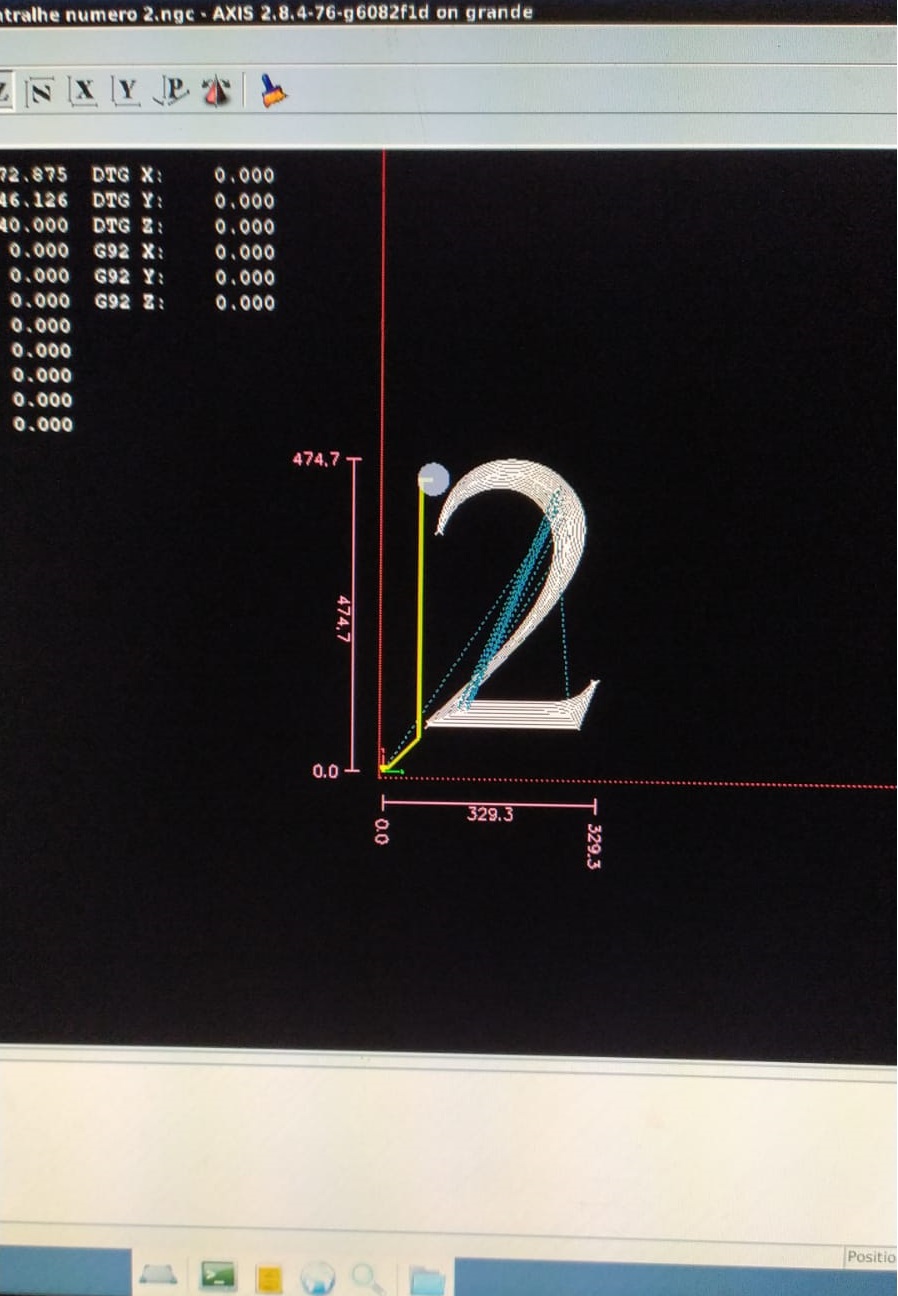

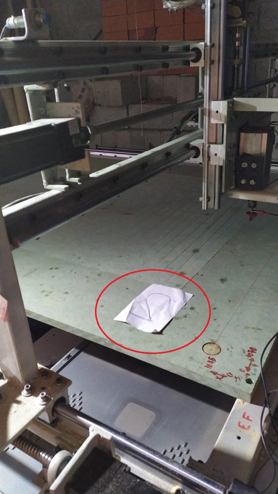

I have another problem, I took two photos:
One of the computer screen showing linuxcnc with the open G code that is used to machine number 2.
The second is the drawing I made of how the machine is executing the machining code for number 2, but inverted/mirrored as I made the drawing on paper and positioned it on the machine.
I tried to change the configuration of the axes and connection of the motors in the drivers and I couldn't solve it.
Could you help me with this too?

14 Jul 2024 20:31 #305184
Replied by tommylight on topic Linuxcnc 2.8.4 does not show tandem items.
X axis is backwards, change the direction pin if using wizard, or add/remove - in from of scale/step_scale for the X axis
The following user(s) said Thank You: aparecido

15 Jul 2024 15:36 #305276
by aparecido
Replied by aparecido on topic Linuxcnc 2.8.4 does not show tandem items.
Hi, I did some tests just now, I also ended up inverting the X and Y axis pins in the software and now the machine movement is correct, thanks for the help.
