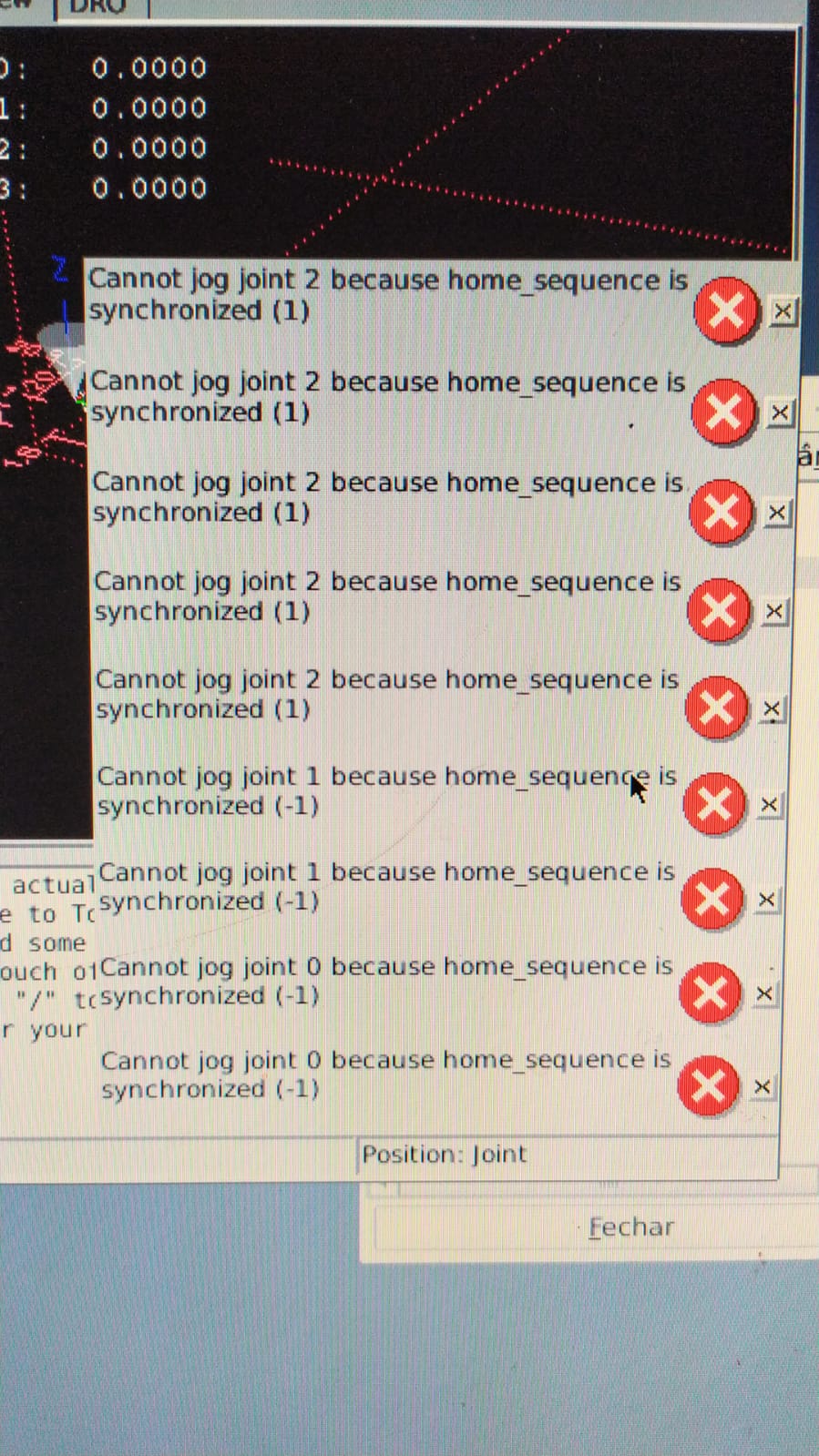

I managed to test it just now and every time I try to move an axis, a new warning like the one in the image appears.
No engine moved...
No engine moved...

You need to Home all before attempting to jog
If you don't have home switches, you will need to add them for a gantry as they are mandatory.

So with this configuration I need to do homming to release movement, right? Before, in the standard configuration of 3 motors, I moved the machine before homing without any problems...You need to Home all before attempting to jog

The joint axes that were added in 2.8 require homing before jogging as your error says.
I just got into the habit of hitting home all after power up so its not onerous and generally not difficult to add the required switches.

In the machine and in the old configuration of this machine that I built now, before using two sensors to square, I had the habit of doing the homing with the inductive sensors on the axes.
But as in the previous format I was able to move the axes before homming, I found it strange that I tried to do the same now and the error message appeared.
I will do new tests as soon as possible, thank you for the information and help.
