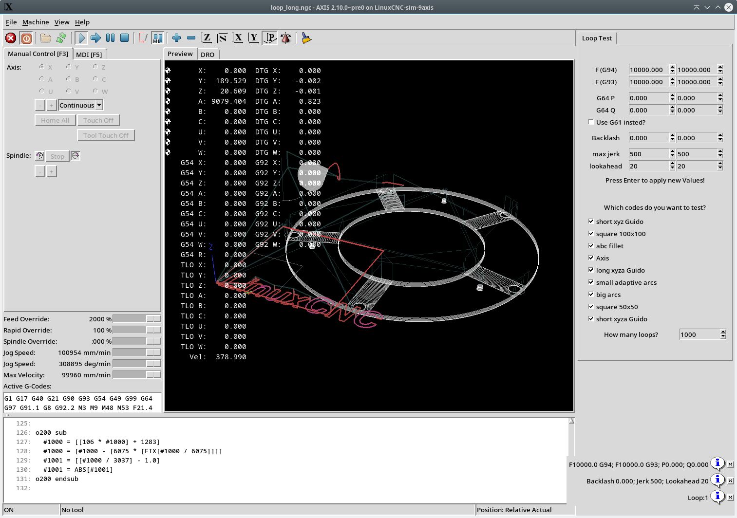

- juliankoenig87
- Posts: 81
- Thank you received: 46
07 Feb 2025 20:57 #320937
by juliankoenig87
Replied by juliankoenig87 on topic scurve trajectory planner
Hi.
So, I tested the scurve with my loop machine for over 18 hourse. No crashes. And I really try to torture it with extreme values. I would call it a sucess and really good coding by Grotius. Well done.
I will go on and do some tests and thinking of backlash compensation this weekend. Have some thoughts but have to figure it out first.
The following user(s) said Thank You: tommylight, Beef, Unlogic
- Beef
- Posts: 43
- Thank you received: 54
07 Feb 2025 21:17 - 07 Feb 2025 21:22 #320939
by Beef
Replied by Beef on topic scurve trajectory planner
@Coyote no I didn't have any role here. This is all Grotius' genius on display. I got buried under school responsibilities and managing now two businesses so I haven't been too active in machining over the last year
@ihavenofish this is beyond dad joke into grandpa joke territory
@Grotius I have tested the scurve on my machine for motion (although I haven't tested probing/toolsetting/cutting). I somehow managed to destroy a spindle bearing a while back and turn it into a spindle bushing, and I just got a new spindle earlier this week - I should have time to install the VFD into the electronics cabinet next week and set up the new spindle, and will send some videos of cutting differences once that's done.
Last edit: 07 Feb 2025 21:22 by Beef.
The following user(s) said Thank You: Coyote, Grotius

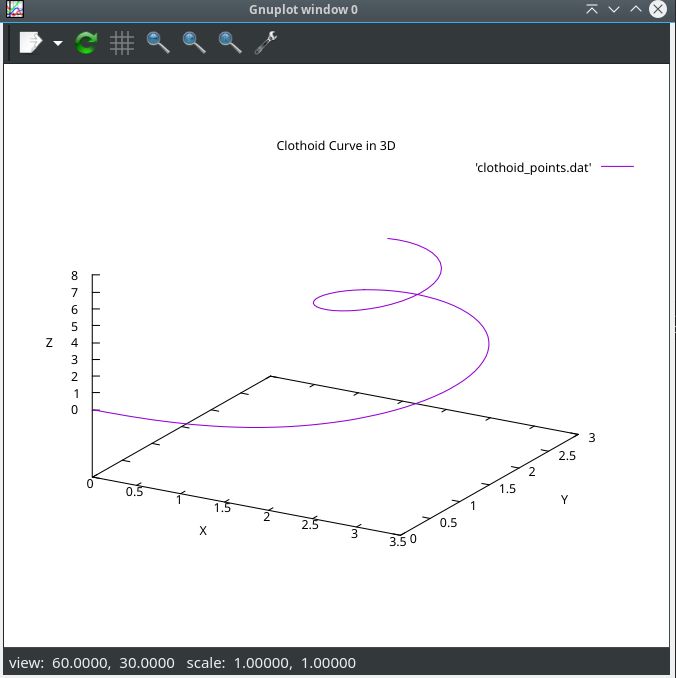

- Grotius
- Posts: 2399
- Thank you received: 2311
10 Feb 2025 01:43 #321132
by Grotius
Replied by Grotius on topic scurve trajectory planner
I thought, mabye just start coding a clothoid lib. And try to
understand how 3d clothoids work.
I followed this paper, the same as Andrew used : 2d clothoid
Then coded chapter 4 into c code.
Was also able to look into Andrews clothoid code from where i
borrowed the gaus legendre.
With a little assistance of DeepSeek i was able to get a single 2d clothoid
running and plotted with gnu plot.
Then i turned on my experimental mode and tried to expand the signle 2d clothoid
to a single 3d clothoid.
The 3d clothoid uses torsion. To keep it simple i used simple names in the c code.
theta0 & kappa0 -> xy
theta1 & kappa1 -> z
I think the hard part is really the bi-clothoid fitting, wich has to be coded yet.
Code so far:
libclothoid
Gnu plot of single 3d clothoid:
Code so far:
libclothoid

10 Feb 2025 08:35 #321143
by automata
Replied by automata on topic scurve trajectory planner
Hi Grotius,
I feel that for 3 axis Gcode, your earlier method of applying 2D bi-clothoids by considering them in the plane holding the two lines should be sufficient for line-line, line-arc and arc-line cases. Only in arc-arc case, you may run into this 3D clothoid / torsion scenario.
-automata
-automata
