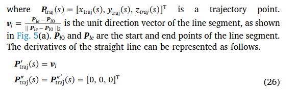

like Aciera said. tilde means the object is in the transformed coordinate system and the numbers of ' show the order of the derivative in respect to curve lengths s. In this case they are from the boundary condition trajectories (lines or arcs) so you get the expression from multiplying equation (26) or (27) with the transformation matrix. Well 26 is easy as 0 stays 0.

Hi Grotius,
where are you stuck with equation 40? the thetas you already have from the prev equation (39) and the tilded x" y" z" are the transformed derivatives of the starting and end points. If we connect with lines they are all 0 eq. (26). With arcs they are given by eq. (30) + transformation.

To me it looks like eq. 40 is all about k, kappa (curvature).
Then x~``traj(s0) for example :
- This is second derivate = curvature, given the ``
- Is already transfomed, given the ~ above the x
- Is for startpoint s0.
- Is for x coordinate.
- It is the curvature kappa value for the transformed startpos?
- I now get it, that a line has no curvature, so value is : 0
- So for a arc, we just put in the curvature value like : "1/Radius" normally.  But they use eq.30 :   -1/r*cos(s/r).....etc.... Why so difficult?

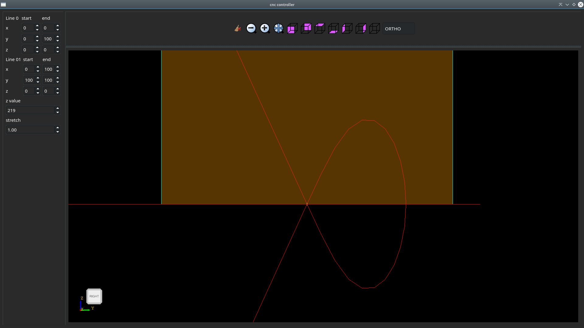

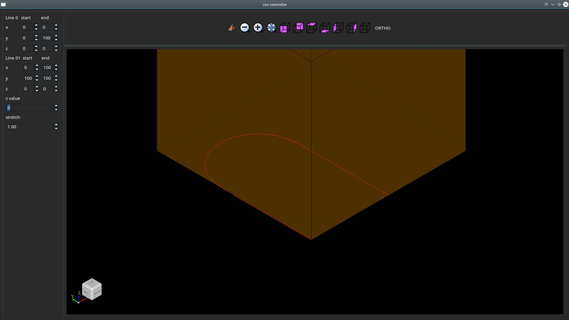

Setup:
2 red lines, lenght 100mm, are connected by a clothoid at xy ground plane.
The lines have a offset 100mm.
After drawing the clothoid, we know the clothoid total length.
Test:
For the first line we lift the startpoint off the plane, given the z value.
For the second line we lift the endpoint off the plane, given the -z value.
Then both lines are out off plane, they don't share any plane anymore.
Still we are able to project a clothoid on the groundplane.
In the second picture the z value of one end of the line is already z219 and z-219.
On the ground plane i projected the red 2 lines, given the yz plane. (side view)
between the 2 lines is the clothoid lenght for xy. So clothoid is streched out to straight line.
Then another algo growns the xy lenght until the 3d clothoid ends are colinear to the red lines in 3d.
Last edit: 12 Feb 2025 20:17 by Grotius.
The second derivative is not the curvature, the first one is.
This means you need to enter the value of the already transformed trajectory. If we want to use eq. 30 for this we need to transform it first because there it is given before the transformation.
yes
No, it is the second derivative with respect to curve length s, this is not the same thing as curvature (would be first derivative)
For the line all derivatives are 0. For the arc see above, ti is not the curvature but the second derivative, not sure if it has a name, "curvature of the curvature" basically.
