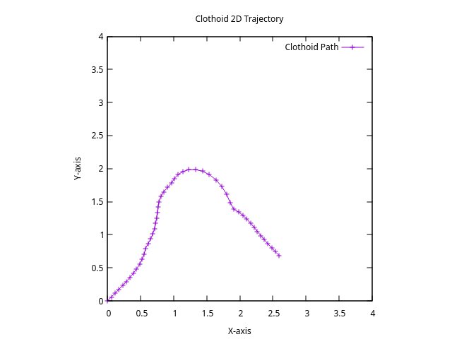

At this stage, we are able to plot something with gnu plot.
In the main.c there is a 2d & 3d example.
When having problems, i decided to revert to implement the 2d solution from eq.46, to get a more simpler overall calculation.
To focus on the 2d solution. The plot is not as should be.
It plots 4 connected clothoids. But the start angle of upcoming clothoid looks to be inverted.
The clothoid compound start, end angle seems to be ok. Start at 45 degrees, end at -45 degrees.
This 2d examples does not focus on the transformation equations. As these transformations can be seen completely seperate.
And it does not use the dogleg solver. It turns out without dogleg solver, initial guess values are most of time ok.
For 2d, there are 2 unknown variables. y21 & s1. In the sample i set a value for y21=1 & for s1=1, this seems to work ok.
Reviewing my code would be appreciated.
updated source
Here is the 2d plot.
17 Feb 2025 16:36 #321845 by Aciera
Replied by Aciera on topic scurve trajectory planner
Thanks for all the work!
At a first glance I'm a bit confused what you are doing in your test. Why are you using equations 17..20 and 44?
In my opinion the workflow should be like this.
1. eq 25, 26 or 29,30 depending on type of segments (line or arc)
2. eq 31, 32, 33 to calculate the transformation matrix T
3. eq 35 calculate the transformed derivatives
4. eq 39 calculate theta_1,0, _2,0, _1,4 and _2,4
5. eq 40 calculate kappa_1,0, _2,0, _1,4 and _2,4
6. eq 43,42 calculate c_1,0, _2,0, _1,4 and _2,4
7. dogleg to calculate gamma_1,1, _2,1 and s1
8. eq 45 to calculate the rest.
I'll have a more in depth look tomorrow.

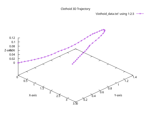

17 Feb 2025 18:20 #321851 by Aciera
please, could you also put the 'dogleg' dependency on the repo?
  • Grotius
  • Grotius's Avatar Topic Author
  • Offline
  • Platinum Member
  • Platinum Member
17 Feb 2025 19:52 - 17 Feb 2025 20:01 #321861 by Grotius
Replied by Grotius on topic scurve trajectory planner
@Arciera,
Pff. If you don't know what you are doing. It's kind off keeping the patience for a long long time.
updated source
I removed the dogleg dependencies for now. it's not used at this moment. Later on will activate it again.
To know more about eq44 and how it works, i started at your item 7, and used not the dogleg, but a initial guess value.
Then to item 8.
It seems now to plot a clothoid 4 compound in 3d.
I used eq.14 as a startpoint to get succes.
Using xy angle 45 degrees at start.
Using z angle 45 degrees at end.
Basicly i understand how the dogleg algo works.
It run's a given function until the function result is within treshold, <1e-6.
It uses one or more variables with a initial guess value. It also updates a inverse jacobian "J" in the iteration, wich
i think we need, but not for sure.
However, if you compute function eq44_G123, the function error is alway's near absolute zero.
As a result of that, the dogleg solver does nothing at this moment.
1. Basicly eq44 is not ok. It should return a error value, then dogleg can optimize.
2. I don't understand yet, how to get the clothoid compound to fit the given end point.
And for info. I did not use any fresnel header file, fresnels are not used, maybe also wrong.
Last edit: 17 Feb 2025 20:01 by Grotius.

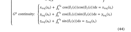

18 Feb 2025 07:40 - 18 Feb 2025 08:14 #321898 by Aciera
I guess the error is in the end position (se)
In my opinion that is what the dogleg is supposed to work with:
subtract the right side from the left we get 3 equations :
x_traj(s0) + integral_term - x_traj(se) = 0
y_traj(s0) + integral_term - y_traj(se) = 0
z_traj(s0) + integral_term - z_traj(se) = 0
However I don't know how to calculate the integral_terms in the algorithm.
Also we need dogleg to solve for 3 unknown variables using the system of 3 equations above which it apparently can do but I have no idea how to set that up.
Last edit: 18 Feb 2025 08:14 by Aciera.

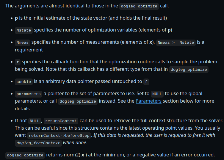

18 Feb 2025 08:28 #321900 by Aciera
Looking at the readme in the dogleg library:
github.com/dkogan/libdogleg?tab=readme-ov-file
It seems that we might want to start with 'dogleg_optimize_dense' or 'dogleg_optimize_dense2' as these calls don't expect a Jacobian.
'p' would be a vector with 3 elements [gamma_1,1, gamma_2,1, s_1] containing our initial guesses when calling and the optimized results in the end.
'Nstate' = 3
'f' would be the system of 3 equations in the last post. This is where I'm stuck at the moment.

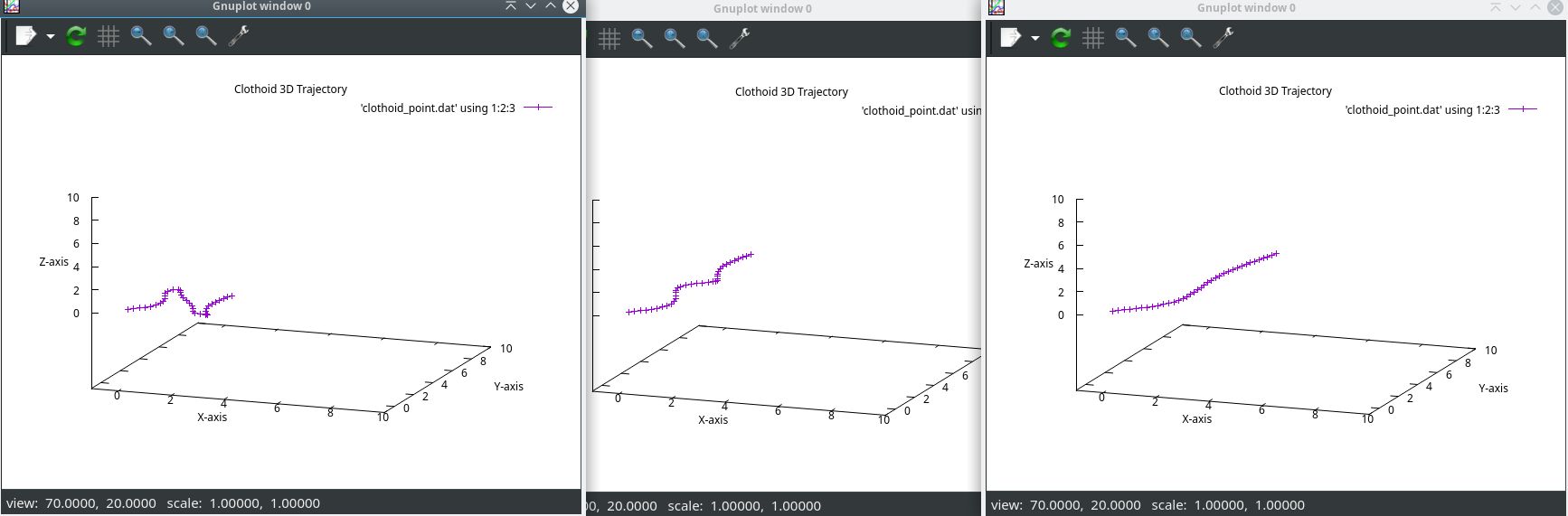

18 Feb 2025 09:48 #321904 by Grotius
@Arciera,
Thanks for your responce.
Indeed, the error is likely the endpos. I was thinking the same yesterday night.
error = distance "requested endpos" - "guess endpos"
When playing with different Y11, 21 gues values using the same length s1:
Changing the guess values Y11, Y21 will influence the rigid of the clothoid compound.
Picture values from left to right :
Y11=1 Y21=1
Y11=0.5 Y21=0.5
Y11=0.1 Y21=0.1
Now i will try to setup the dogleg method. Using our new criteria.
The Jacobian usage seems to be more effiecient in finding the solution. But without is also no problem and
will result in more iterations to find the fit solution.
Your point at eq44 if solved here as a example : eq14
This eq14 is not a optimized function yet.  And for calculating the clothoid endpoint, i want to make a
few one liners today.
Plan :
1. Create a function to calculate the spline endpoint efficient, using y11, y21, s1.  Eq14 current code is not effiecient for this.
2. Create a Dogleg fit function to optimize y11, y21, s1 values that the spline compound fit's the given endpoint. (Magic function).

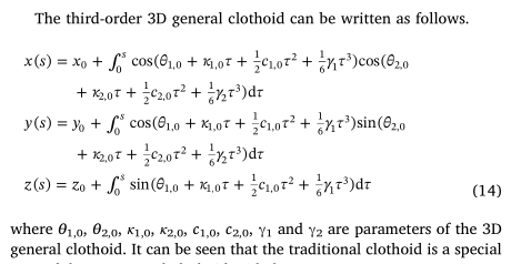

18 Feb 2025 10:10 - 18 Feb 2025 10:12 #321905 by Aciera
yes, eq 14 :
because we set s1=s2=s3=s4 we need to integrate from 0 to 4*s1.
It's still unclear to me how dogleg optimizes a system of 3 equations as it would not get back a single residual value but rather a vector with 3 residual elements.
Last edit: 18 Feb 2025 10:12 by Aciera.
18 Feb 2025 10:23 #321907 by Aciera
I guess we could simply calculate the length of our 3D residual vector and pass that back as the error value to be minimized.
