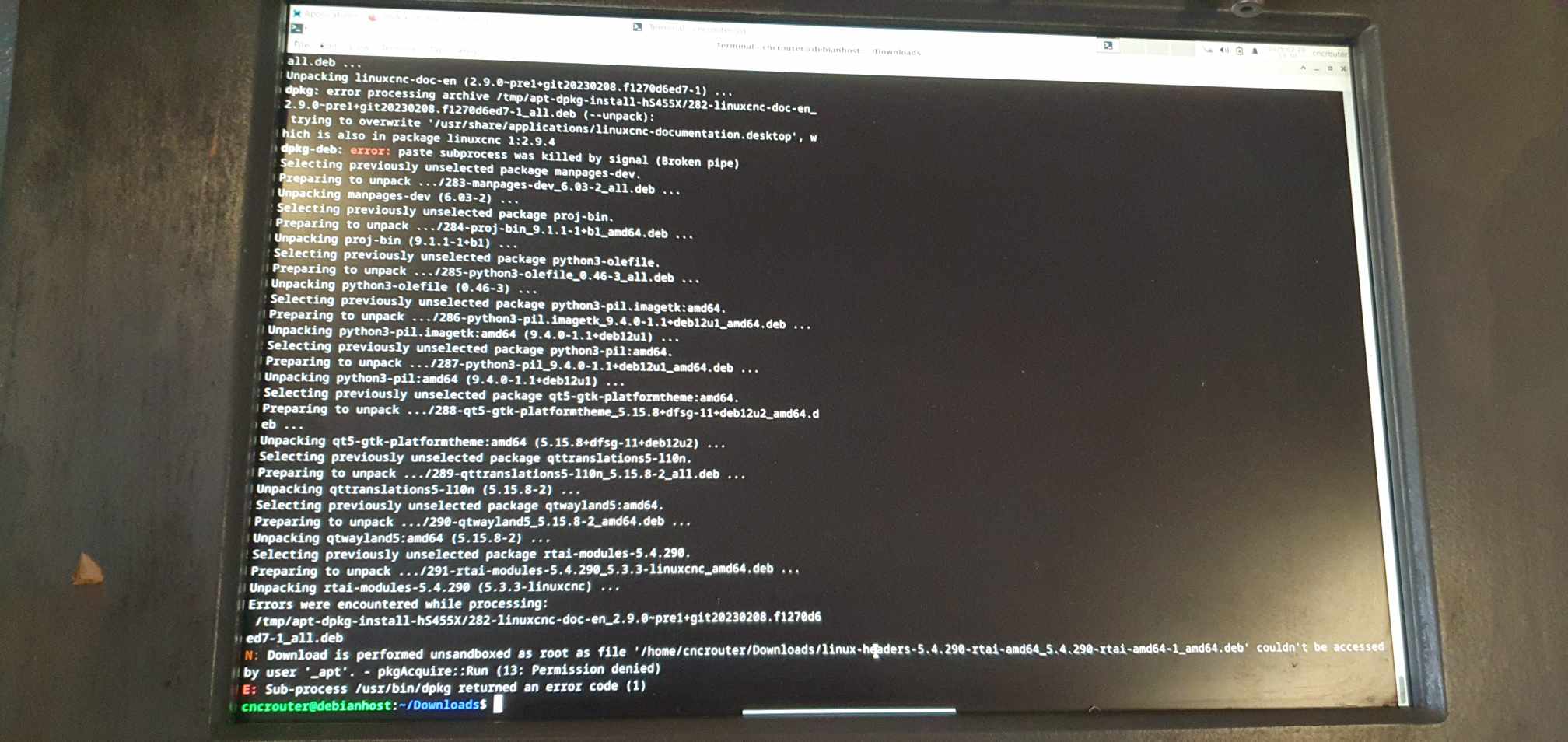

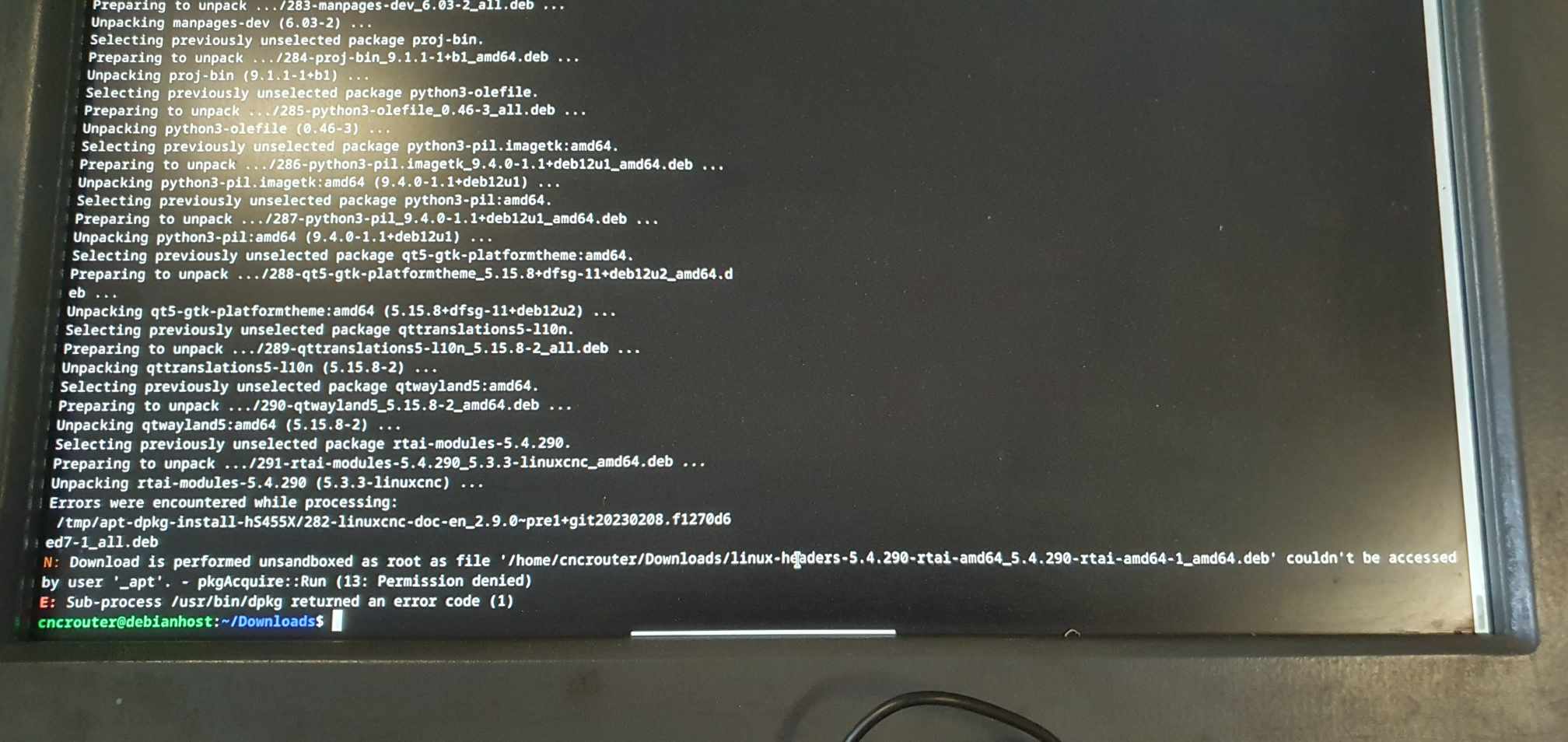

20 Feb 2025 12:59 #322059
by denhen89
Replied by denhen89 on topic (LPT) Debian 12 Latency spikes/unexpected real time delay. Looking for solution.
Its just unbelievable... why god damn it cant work..
What i did:
1. fresh install of debian 12
2. downloaded every file from onelaboratories.us/abc/
3. went to downloads folder and opened a terminal
4. first i tried "I think that placing these deb files in a separate folder and entering: sudo apt update && sudo apt install ./*.deb will be the easiest way"
NOT WORKING - if i remeber correctly, something is missing
5. then i tried this: sudo dpkg -i (package name here without brackets)
5.1: i started with: sudo dpkg -i linux-headers-5.4.290-rtai-amd64_5.4.290-rtai-amd64-1_amd64.deb
5.2: sudo dpkg -i linux-image-5.4.290-rtai-amd64_5.4.290-rtai-amd64-1_amd64.deb
5.3: sudo dpkg -i rtai-modules-5.4.290_5.3.3-linuxcnc_amd64.deb
5.4: sudo dpkg -i linuxcnc_2.9.4_amd64.deb
Dont ask me why in this sequence. I just did that because no where its described with which deb to start.

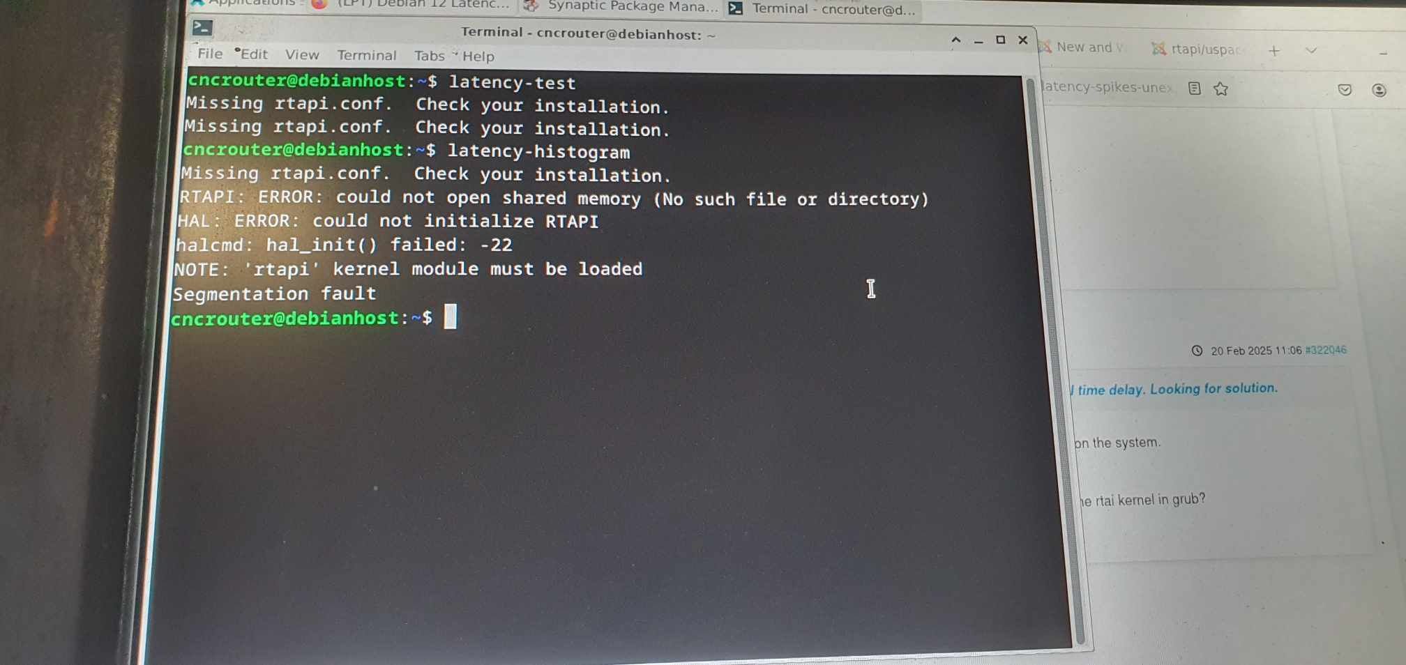

As you can see on the pictures there are things missing.
I then tried to open Latency test fom the drop down (xfce) menu but nothing happend, then i opened terminal and wanted to open it through command.You can see the result on the last pictures.
Guys, please tell me what i did wrong.

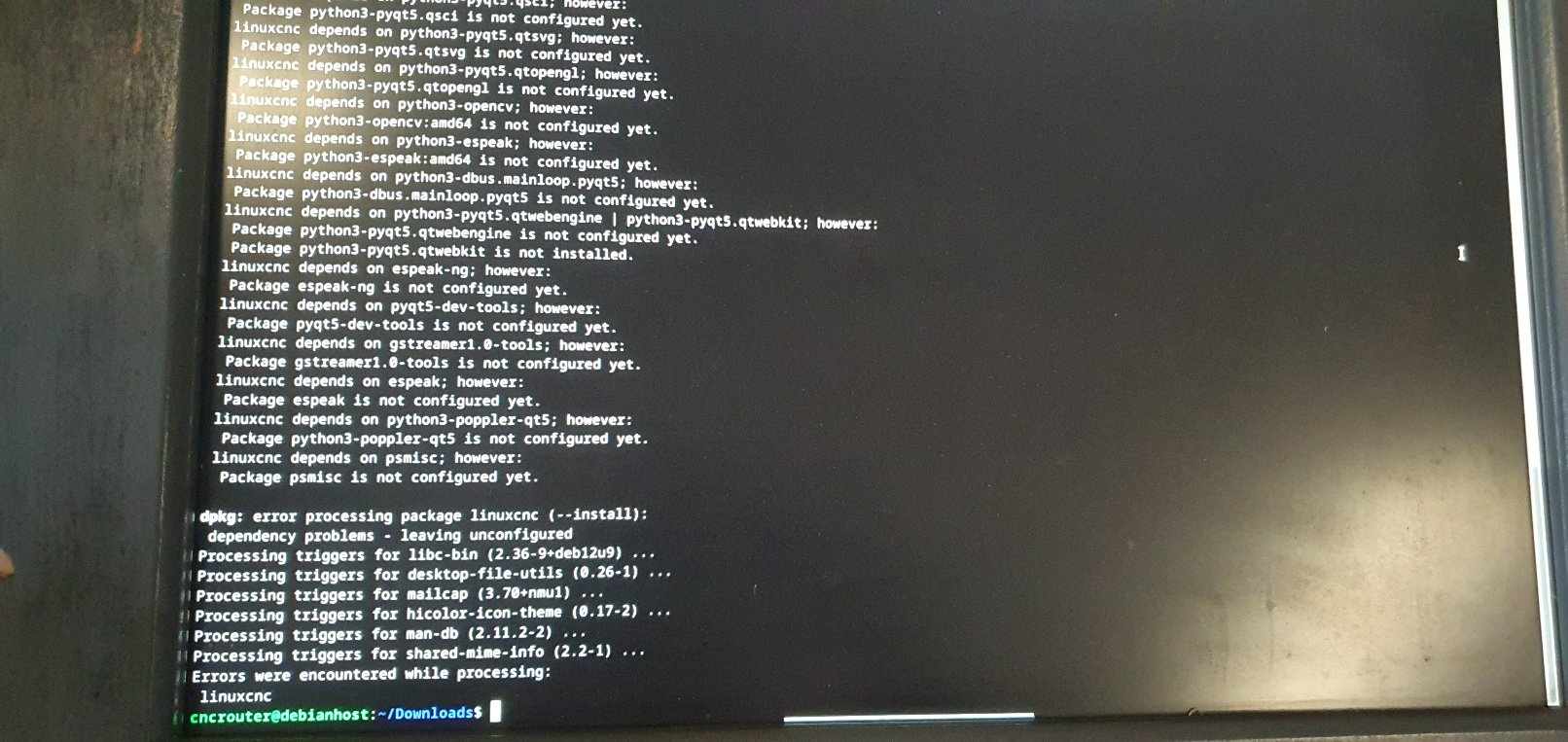

UPDATE:
i did again a fresh install of Debian 12 and did the same as described in my previous post with sudo dpkg -i (package name here without brackets).
I then opened Synaptic pacakge manager and it showed me a broken package, which was linuxcnc. I clicked on it and did complete removal. Then i updated everything that synaptic made available and then again i did sudo dpkg -i linuxcnc_2.9.4_amd64.deb.
When i do Latency-test, the pc freezes.

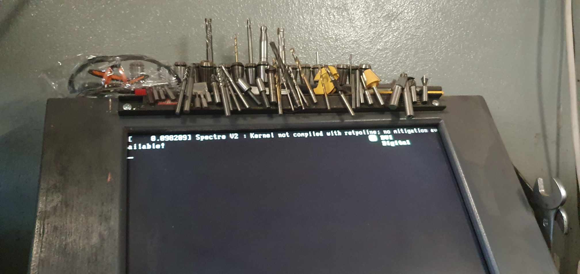

On start up of the machine i get for about 2 seconds the information that you can see on the attached picture.

Getting permission denied from apt is strange, especially since you are correctly running as a normal user.
In about 90% of cases, if you get this error, one of the memory modules is on the way out, so it might be time to dust off your PC and check the memory.
If you do have another PC, you can install everything there and move the drive after finishing to this PC, that almost always works properly with Linux. Almost for me is 1 failed boot in about 500.
