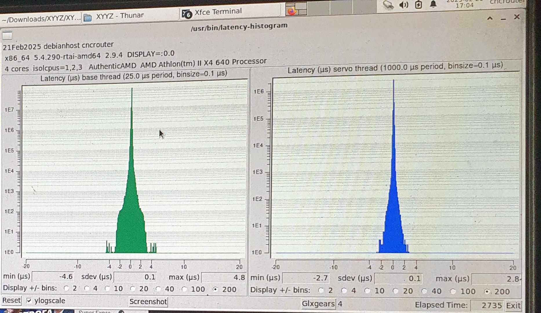

20 Feb 2025 17:53 #322097
by denhen89
Replied by denhen89 on topic (LPT) Debian 12 Latency spikes/unexpected real time delay. Looking for solution.
So, i could open Linuxcnc ones after i got a error message on start up, but after reboot i get the error message all the time, so i am not able to start linuxcnc.
I wanted to attach the report file, but cant upload that file type, so i just paste it here. sorry that but i want out of the workshop now, i have enoug and mz hands a freezing.

LINUXCNC - 2.9.4
Machine configuration directory is '/home/cncrouter/Downloads/XYYZ'
Machine configuration file is 'XYYZ.ini'
INIFILE=/home/cncrouter/Downloads/XYYZ/XYYZ.ini
VERSION=1.1
check_config:
INCONSISTENT coordinates specifications:
trivkins coordinates=XYYZ
[TRAJ]COORDINATES=XYZ
PARAMETER_FILE=linuxcnc.var
TPMOD=
HOMEMOD=
TASK=milltask
HALUI=halui
DISPLAY=axis
COORDINATES=X Y Z
KINEMATICS=trivkins coordinates=XYYZ

RTAPI: ERROR: Unexpected realtime delay on task 1
This Message will only display once per session.
Run the Latency Test and resolve before continuing.

[ 94.539313] I-pipe: head domain RTAI registered.
[ 94.539441] RTAI[hal]: mounted. ISOL_CPUS_MASK: 20.
[ 94.539447] SYSINFO - # CPUs: 6, TIMER NAME: 'lapic', TIMER IRQ: 4355, TIMER FREQ: 6270499, CLOCK NAME: 'tsc', CLOCK FREQ: 1404706000, CPU FREQ: 1404706000, LINUX TIMER IRQ: 4355.
[ 94.549853] RTAI[malloc]: global heap size = 2097152 bytes, <BSD>.
[ 94.549901] kstacks pool size = 524288 bytes
[ 94.549903] RTAI[sched]: hard timer type/freq = lapic/6270499(Hz)
[ 94.549904] linear timed lists.
[ 94.549908] RTAI[sched]: Linux timer freq = 250 (Hz), TimeBase freq = 1404706000 hz.
[ 94.549912] RTAI[sched]: timer setup = 159 ns, resched latency = 0 ns.
[ 94.554302] USERMODE CHECK: OK.
[ 94.554306] USERMODE CHECK PROVIDED (ns): KernelLatency 1772, UserLatency 2726.
[ 94.554308] FINAL CALIBRATION SUMMARY (ns): KernelLatency 1772, UserLatency 2726.

identityKinematicsSetup: coordinates:XYYZ
[ 94.668564] Joint 0 ==> Axis X
[ 94.668566] Joint 1 ==> Axis Y
[ 94.668567] Joint 2 ==> Axis Y
[ 94.668568] Joint 3 ==> Axis Z
[ 94.668570] identityKinematicsSetup: Recommend: kinstype=both

[ 98.568211] RTAPI: ERROR: Unexpected realtime delay on task 1

21 Feb 2025 17:06 #322216
by denhen89
Update:
The machines works again, without unexpected real time delay and a very good latency, but i had to take the PC of my Lathe. (the lathe machine uses the Mesa 7i76e card)
That PC has a on-board graphic card, but i first tested it with the VGA that was already there and i got the same latency issues. As soon as i used the on-board vga, the latency was perfect and no "realtime errors" at start up.
I have started latency-histogram, with 4 x glxgears and a youtube video running for about 1 hour.
I first started the histogram, then opened one glxgears and waited to check if anything spikes happen. Then i opened 3 more glxgears. No latency spike. Then the youtube video and the pc was running like that for almost one hour without any change to the base thread.
On tomorrow i will run a milling program and check if anything bad happens.
