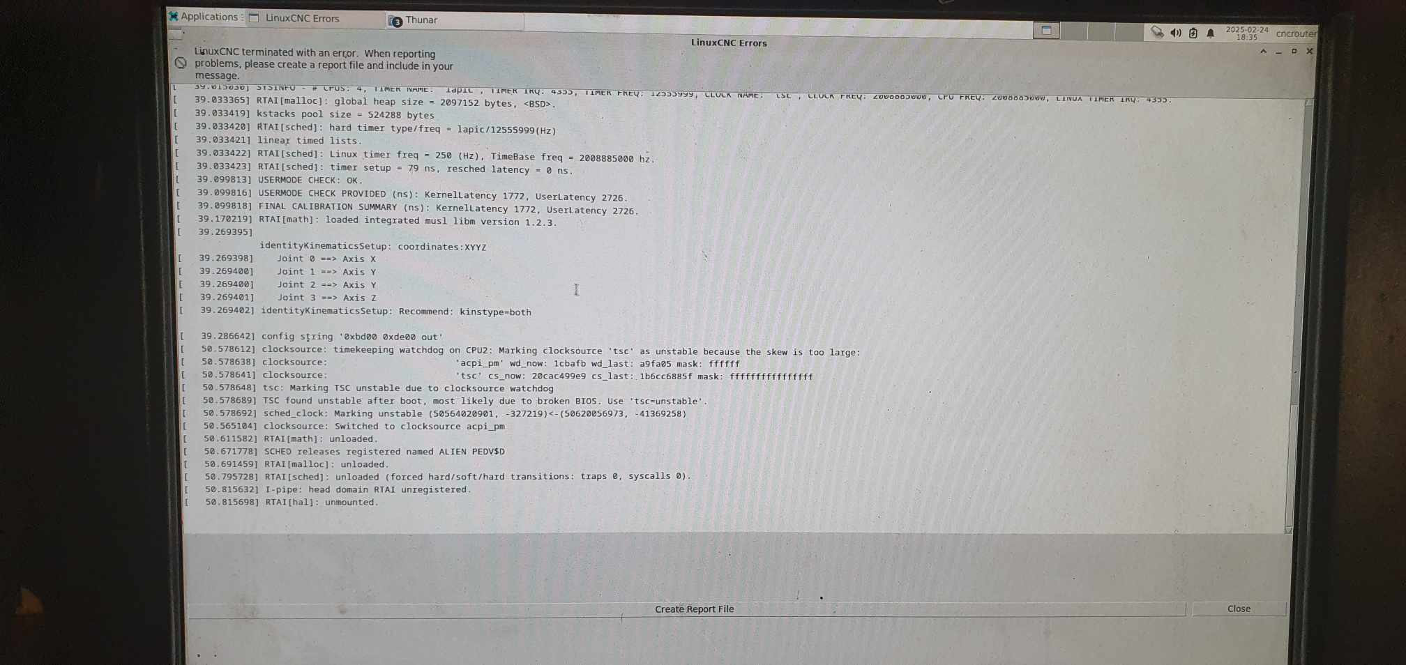

Hello guys,
bad news for me.
Today i installed the VFD to the wall a bit far away from the control box. After i was done, i wanted to check if everything works and check if i still have some noise problems from the VFD.
Due to the fact that i am again totally confused from 5-6hours of trying to fix it, i am not anymore sure if i got the unexpected real time delay on first start up (but later i got it all the time), but i have found out that when i jog by keyboard or mouseclick on the jog buttons quickly, lets say couple of short and quick jogs, then i get a joint following error 0 and the machine is then off. When i put it on and do the same quick and short jogs then i get following error 1. Then again the same and following error 2. (i would not take the sequence serious, i later also got following error 1 first, at least i believe, but i am not 100% sure)
I GET NO FOLLOWING ERROR WHEN:
- Jogging normalny, no quick clicks
- running a program
Is it possible that USB is the problem?
I havent changed anything since i posted the screenshot of the very-good latency in latency-histogram.
More info:

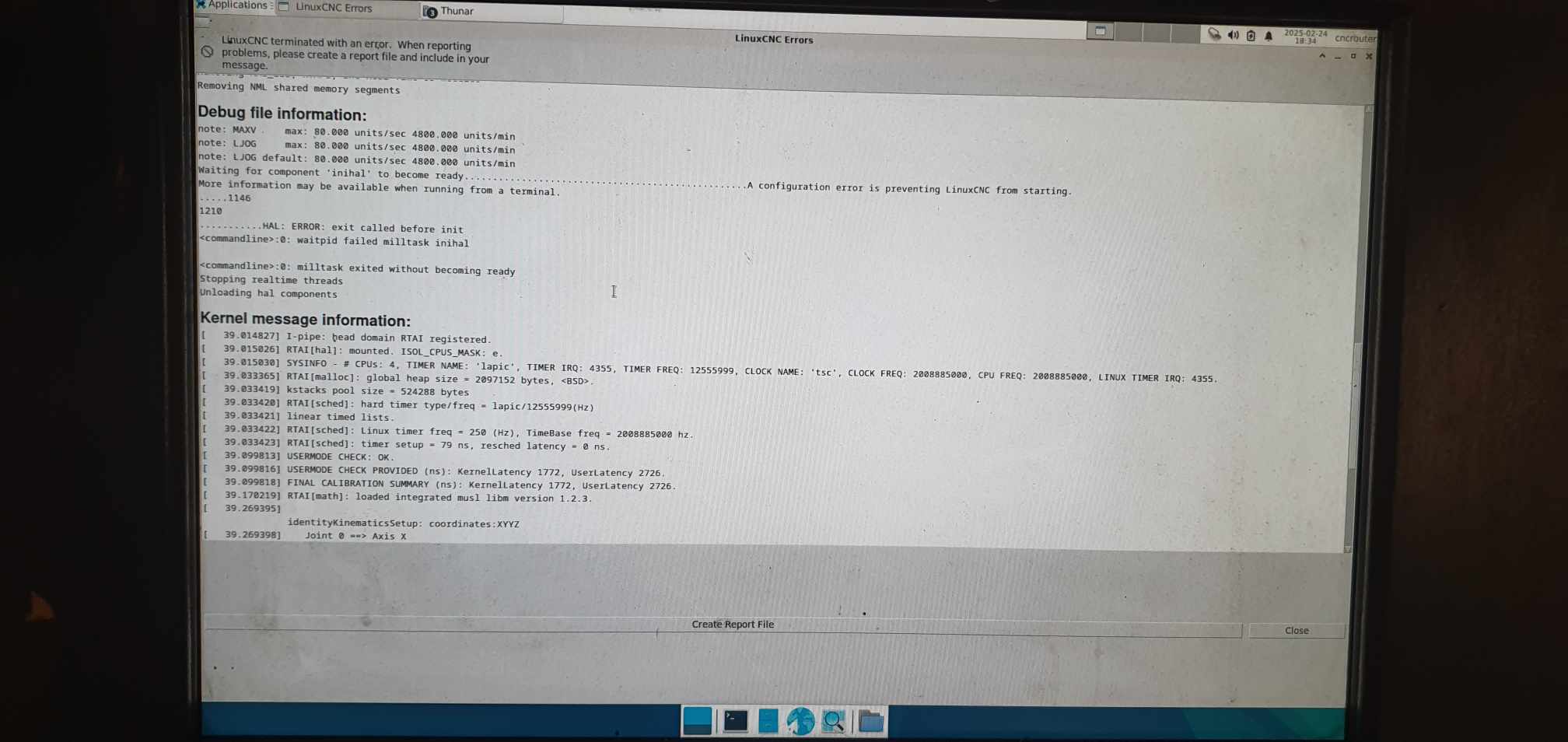

It happens also that when i want to start Linuxcnc i get a error (see picture), but its possible that it starts after trying second or third time.
Also sometimes Linuxcnc got stuck (freeze) or the whole PC, but of course i started to play around with the Bios settings and specific bios settings could create more problem.
I dont have PS/2 keyboard / mouse available to test. Changing two USB settings in BIOS did not help. (legacy usb something and one other option)
So, if you will have no idea, then my only option might be the 7i76eu, BUT i am also thinking to go back to Wheezy and Linuxcnc 2.8, IF its possible to do file sharing with e.g. Samba, but i believe that all tutorials are before windows did something to block the file sharing. Rodw wrote something about it, here in this thread.
PS: I need nothing but working Linuxcnc, mousepad/geany and file sharing or a browser that works so i can send files by mail or open Microsoft OneDrive.

Update with good news:
I decided on yesterday evening to install Debian (7?) wheezy 2.7.x and then i upgraded to 2.9.
- No unexpected realtime delays on start up
- no joint following errors
- strangely, OneDrive is working with rclone, but need to mount everytime after reboot, but i read its possible to automatically mount it.
I didnt test much, but i was 45min ago in the workshop with the pc after 8h latency-histogram test and tested all functions and axis movements. On tomorrow i will do more test.
