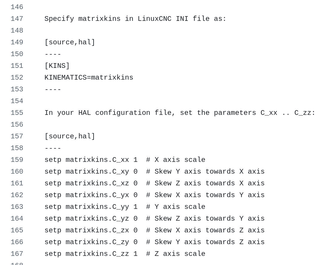

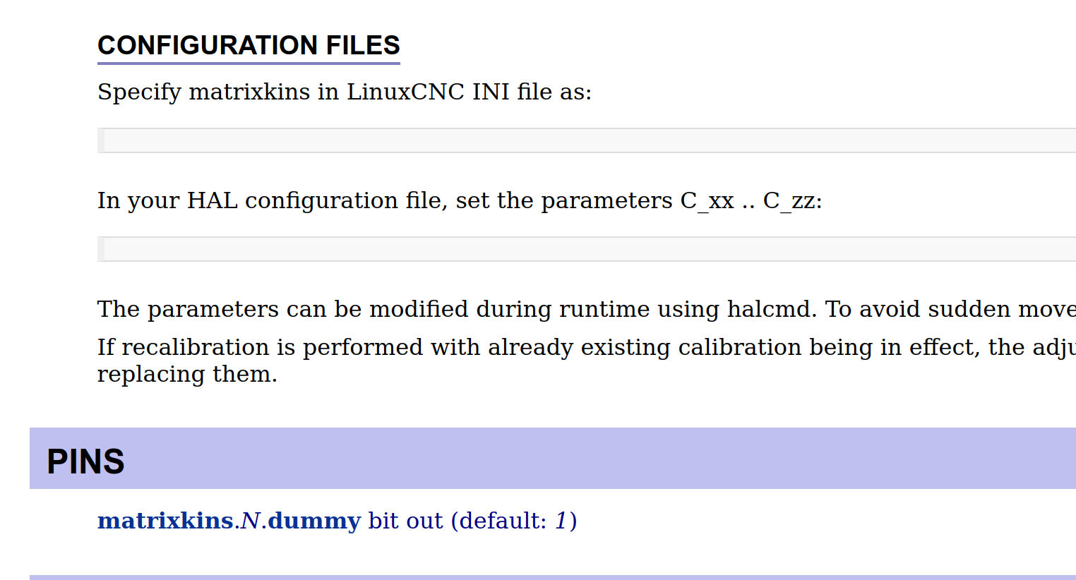

20 Nov 2025 08:37 - 20 Nov 2025 09:04 #338800
by abs32
Replied by abs32 on topic v2.9 and not the perpendicularity of X and Y
Colleagues,
I installed the kernel 5.4.290 + the linuxcnc 2.9.4 build that came with it
With the kinematics option KINEMATICS = trivkins coordinates=XXYYZ, everything starts and works.
We have a description here -
linuxcnc.org/docs/devel/html/man/man9/matrixkins.9.html
the example section of hal + ini files is empty.
We also have a description here -
github.com/LinuxCNC/linuxcnc/blob/master...ents/matrixkins.comp
where examples of specifying matrix elements are indicated.
However, there are no examples for hal + ini.
I tried to do the following by analogy with other methods -
HAL -
#2025-11-20 для версии 2.9.4
#loadrt [KINS]KINEMATICS
#программная коррекция
#https://linuxcnc.org/docs/devel/html/man/man9/matrixkins.9.html
#https://github.com/LinuxCNC/linuxcnc/blob/master/src/hal/components/matrixkins.comp
loadrt matrixkins
setp matrixkins.C_xy 0 # Skew Y axis towards X axis
setp matrixkins.C_xx 1 # X axis scale

I note an error in man - there is no [KINS] section in the HAL file, there is such a section in ini, st 149 -

for kernel 5.4.254, the situation and error are exactly the same (with corresponding linuxcnc + linuxcnc-dev)
how to fix this?

Replied by Aciera on topic v2.9 and not the perpendicularity of X and Y
1. Remove 'loadrt matrixkins' from your hal file
2. The KINEMATICS entry of the [KINS] section in your ini file needs to look like this (matrixkins does not support the 'coordinates' parameter):
KINEMATICS=matrixkinsPlease Log in or Create an account to join the conversation.
