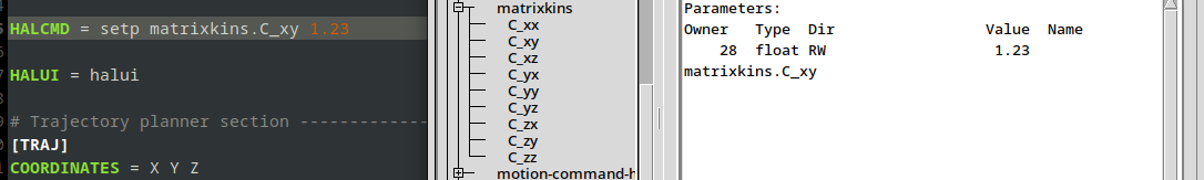

But how to correctly write the value of one of the parameters in the settings? If earlier I could provide in a hal file
setp relkins.adjX.Y0 0
now it's an attempt to indicate
setp matrixkinx.C_xy 0
leads to abortion program launch
Through HalShow, the command setp matrixkinx.C_xy 0 is executed normally.

21 Nov 2025 04:28 #338877
Replied by Aciera on topic v2.9 and not the perpendicularity of X and Y
setting maxkins paramter values certainly works for me.
Example using 'HALCMD' entry in the [HAL] section of the inifile:
parameter values can also be changed during run time using an executable Mcode that calls 'halcmd' tool but doing so on a kinematics parameter may lead to joint following errors.

21 Nov 2025 05:43 - 23 Nov 2025 10:16 #338879
by abs32
Replied by abs32 on topic v2.9 and not the perpendicularity of X and Y
We figured out the setting of the parameters, thank you. The program starts normally. Home search is normal.
But running any g-code program fails. Moreover, an attempt to move manually (with arrows on the keyboard) leads to the fact that only each motor moves separately - i.e. not two X X motors, but one X motor, which immediately leads to an accident.
#2025-11-20 для 2.9.4
#KINEMATICS = trivkins coordinates=XXYYZ
KINEMATICS=matrixkins
Where exactly and how exactly can we now indicate that we have 5 engines and an XXYYZ circuit?
ini-file:
[KINS]
JOINTS = 5
[HAL]
HALFILE = 4.hal
HALCMD = setp matrixkinx.C_xy 0 # Skew Y axis towards X axis
POSTGUI_HALFILE = postgui_call_list.hal
