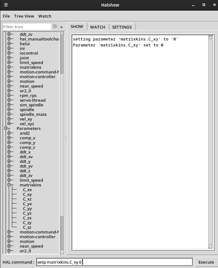

21 Nov 2025 03:52 #338873
Replied by Aciera on topic v2.9 and not the perpendicularity of X and Y
- abs32
- Posts: 77
21 Nov 2025 04:09 #338874
by abs32
Replied by abs32 on topic v2.9 and not the perpendicularity of X and Y
Bravo, thank you!
The interface immediately changed - before home, a choice of individual motors is now available!
There was an error in the perception of the hal file configuration when I tried to write down the parameters
setp matrixkins.C_xy 0
