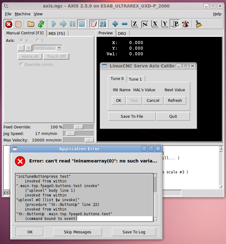

i have changed and now axis will start but
i get this when trying the calibration
can't read "ininamearray(0)": no such variable
while executing
"set ininamearray($axisentry)"
(procedure "iniTuneButtonpress" line 34)
invoked from within
"iniTuneButtonpress test"
invoked from within
".main.top.fpage0.buttons.test invoke"
("uplevel" body line 1)
invoked from within
"uplevel #0
while executing
invoked from within
invoked from within
invoked from within
"uplevel #0
(procedure "tk::ButtonUp" line 22)
invoked from within
"tk::ButtonUp .main.top.fpage0.buttons.test"
(command bound to event)

check your parameter file .. as per the last message
also uncomment the z axis lines in your INI file
Last edit: 25 May 2012 08:19 by cncbasher.

i have changed that now but still the same and im not using a z axis

Unfortunately I have no experience with these boards or what pncconf generates for them.
All I can offer is that these errors
Debug file information:
Can not find -sec MOT -var MOT -num 1
Can not find -sec IO -var IO -num 1
Can not find -sec LINUXCNC -var NML_FILE -num 1
Can not find -sec EMC -var NML_FILE -num 1
seem to relate to parsing of the .INI file not finding variables it expects at the various headings.
This one is strange Can not find -sec EMC -var NML_FILE -num 1
because if the line was not commented out LinuxCNC would throw multiple errors with any version >= 2.4
The second set of errors are tk/python errors, but also seem to relate to problems with the .ini file, either parsing it or even just finding it
Don't know if this helps at all.
regards
regards
