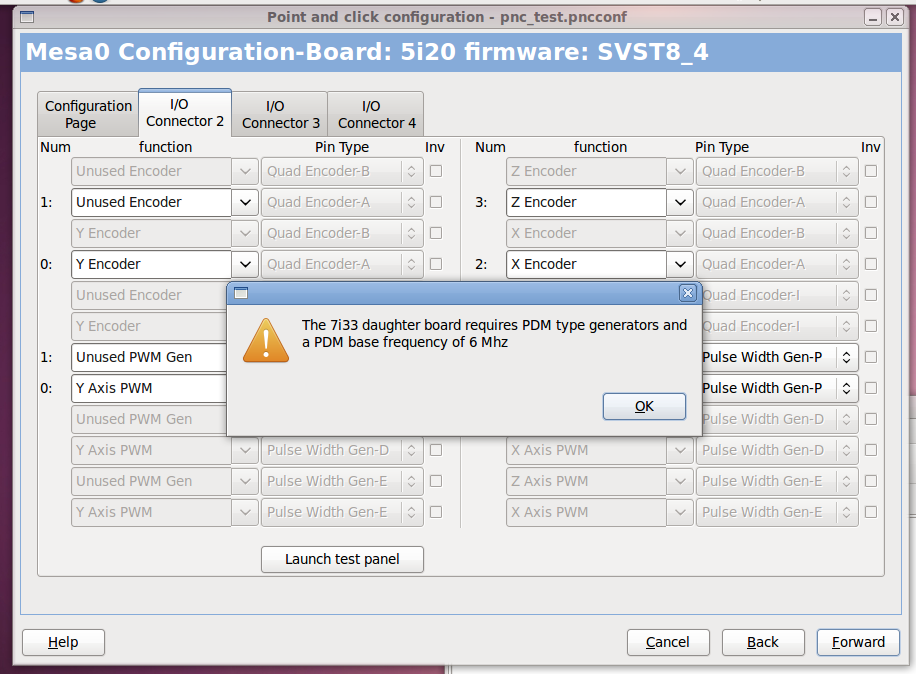

first you cannot change 'alias' to 'setp' so don't do that.
You are using what version of EMC (apparently 2.4.x)
next what was the original error with the original pncconf produced config file?
please post the error and the hal/ini files of the original non editted version.
next what axis are you trying to test - and why have you apparently not configured steppers or PWM for the z axis?
( at least thats what it looks like from some of the HAL files. )
If the open loop test does not work that usually means you have not configured the mesa page properly.
you must have either a stepper or a PWM and encoder for each axis.
It's fairly easy to screwup and have two of one axis instead of one of each axis, and pncconf will not notice this.

hi chris the first problem was the axis calibration window not coming up properly the hal and ini are the ones from version 2.4.x and the only edit is that of changing "alias pin" for setp
however the new problem is this after a fresh install of the latest linuxcnc i get throught the pncconf and can then not do the open loop testing the axis config is only two axis as the machines a plamsa gantry it has no z axis that emc controls (standalone hight control) am i better just congifing one anyway as this maybe upgraded at some point also if im going to confnig three axis am i better changing the number of encoder coounters and pwms to three or will this not affect the problem ?
the x axis im testing

Can not find -sec MOT -var MOT -num 1
Can not find -sec IO -var IO -num 1
Can not find -sec LINUXCNC -var NML_FILE -num 1
Can not find -sec EMC -var NML_FILE -num 1
HAL: ERROR: function 'pid.0.do-pid-calcs' not found
my_EMC_machine.hal:20: addf failed

25 May 2012 06:48 #20370
by cncbasher
Replied by cncbasher on topic Re:5i20 7i33 7i37
arh ok typo on my part sorry !
change
addf pid.0.do-pid-calcs servo-thread
to
same with chan 1 to y
change
to
- jd896
- Posts: 120
25 May 2012 06:48 #20369
by jd896
Replied by jd896 on topic Re:5i20 7i33 7i37
- cncbasher
- Posts: 1744
- Thank you received: 288
25 May 2012 06:54 - 25 May 2012 07:00 #20371
by cncbasher
just untick the sanity check for the 7i33 should work
and over ride the checks
are you using the 7i33 ? , if so set the pdm freq to 6mhz would get you round it too perhaps
Last edit: 25 May 2012 07:00 by cncbasher.
