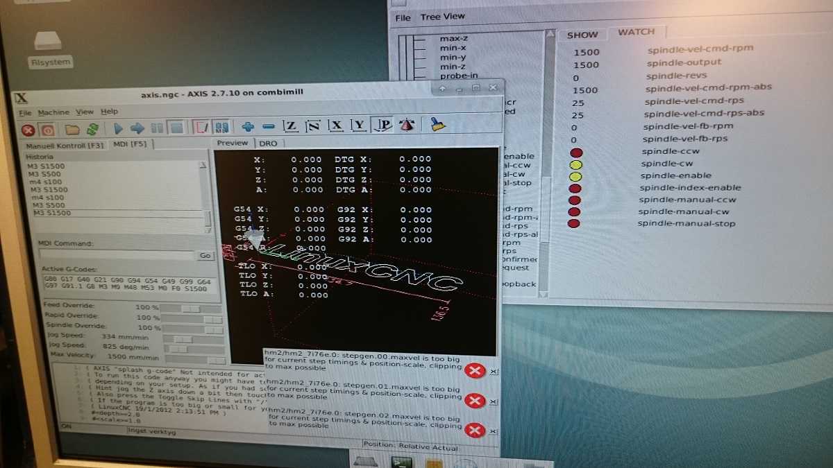

The scalemax should definitely be the spindle speed that corresponds to 5V input at the VFD.
The question is what might be limiting your maximum spindle speed.
Replied by andypugh on topic Help needed to get my 7i76E + 7i85S + 7i73 on my mill going.
"That is what puzzels us now also no S command reaction either none or flat out depending on scale factor.
- Posts: 19908
- Thank you received: 4660
31 Jul 2017 14:30 #96789
Does M3 S1000 give you only 101 rpm at the motion.spindle-speed-out pin?

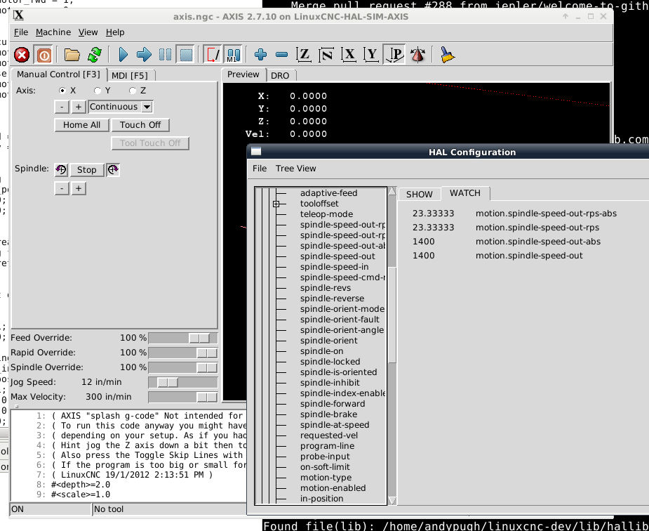

31 Jul 2017 16:03 #96793
Can you open a sim config (sim axis axis for example) and see if the same thing is true there?

01 Aug 2017 04:50 #96814
No, this is slightly different. motion.spindle-velocity-cmd-rpm-abs is showing the correct number.
What do the hm2_5i25.0.7i76.0.0.spin* pins show?
And, what is the value of the related scale and limit parameters?
