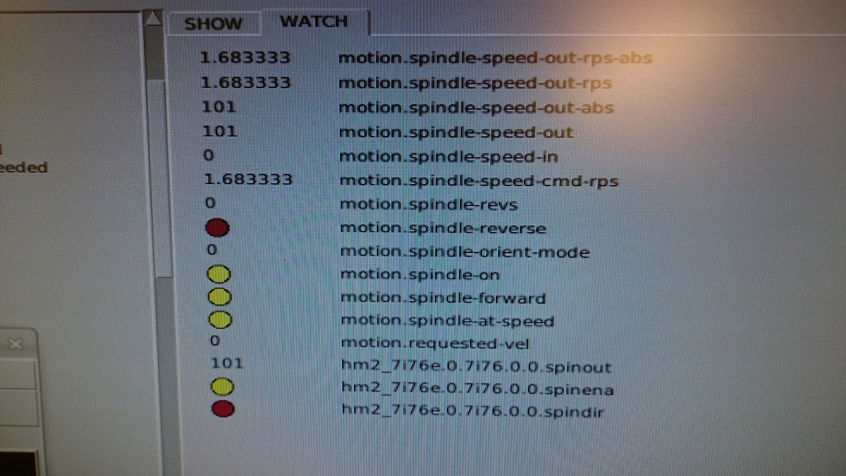

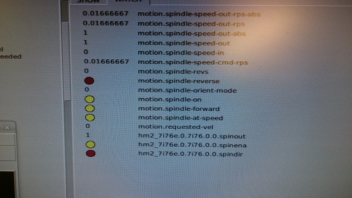

scalemax 2000 puts out 0.248V
scalemax 5 puts out 4.36V after 1 push on + and from start 0.926V
So when you push clockwise spindle rotates slowly 1 + and it goes flat out.
None what soever reaction on S command.

31 Jul 2017 10:14 #96779
That's odd. Which LinuxCNC version?
I don't even think that there is a speed limit configurable that might be wrong.
You are looking at the motion.spindle pins?
Replied by andypugh on topic Help needed to get my 7i76E + 7i85S + 7i73 on my mill going.
"Spindle speed starts at 1rpm and goes up in 100rpm increments for each push of the + button."
That is not the case = starts at 1 and then 101 after 1 push on + but no more after that even if you push 5 times or more!

31 Jul 2017 10:17 #96781
by tecno
Replied by tecno on topic Help needed to get my 7i76E + 7i85S + 7i73 on my mill going.
Haven't upgraded for a few days so it is still .10
Will go down to workshop and have a closer look at those pins.
