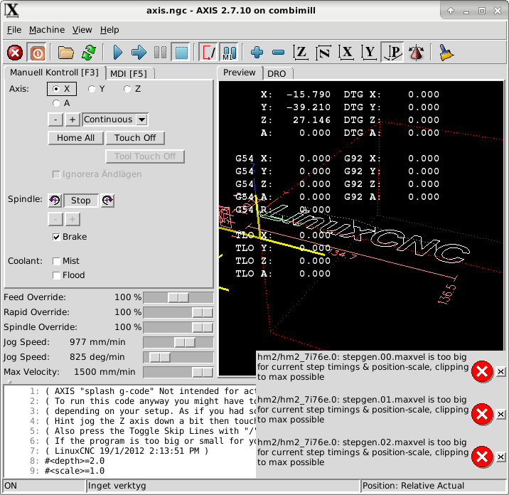

30 Jul 2017 06:02 #96677
by tecno
Replied by tecno on topic Help needed to get my 7i76E + 7i85S + 7i73 on my mill going.
OK now I have motion on 3 axis (A-axis is coming in near future) and the brake works as wanted. Thanks Rod and Andy.
As you can see I get some errors so fine tuning of motor parameters needs some editing.
Z homing is going in wrong direction,

30 Jul 2017 06:24 - 30 Jul 2017 06:25 #96678
Replied by rodw on topic Help needed to get my 7i76E + 7i85S + 7i73 on my mill going.
Awesome! Homing direction is controlled by the sign of the various homing velocities in the .INI file.
I'll let Andy or someone respond about the errors but I think it will be something to do with these
You might like to read up on them as they are well covered in the documentation. Step scale sounds very large. 5000 steps per mm? if correct and you have microstepping settings, try reducing it.
HOME_SEARCH_VEL = -1.000000
HOME_LATCH_VEL = -0.500000
HOME_FINAL_VEL = 0.000000I'll let Andy or someone respond about the errors but I think it will be something to do with these
DIRSETUP = 1000
DIRHOLD = 1000
STEPLEN = 1000
STEPSPACE = 1000
# 1000 original setting
STEP_SCALE = 5000.0You might like to read up on them as they are well covered in the documentation. Step scale sounds very large. 5000 steps per mm? if correct and you have microstepping settings, try reducing it.
