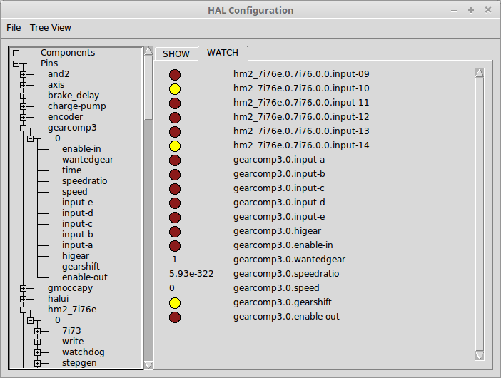

OK, so I got the comp installed on my milling machine but something is wrong. Can you guys see what is wrong here?
I was off by one digit on my inputs in HAL
but now corrected.
In picture below I have higear + input_b but only input pins on 7i76e shows nothing in gearcomp3

Looks Ok given the input. The component want you to change gear but doesn't know to which gear, since the speed is zero,
But I see input-as, they are all zero,. Can you show the relevant parts of the hal file with loadrrt, addf and all signals where gearbox3 is involved?

loadrt trivkins
loadrt [EMCMOT]EMCMOT servo_period_nsec=[EMCMOT]SERVO_PERIOD num_joints=[TRAJ]AXES
loadrt hostmot2
loadrt hm2_eth board_ip="10.10.10.10"
setp hm2_7i76e.0.watchdog.timeout_ns 5000000
loadrt pid names=pid.x,pid.y,pid.z,pid.a,pid.s
loadrt charge_pump

19 Aug 2018 09:43 - 19 Aug 2018 09:44 #116313
by tecno
Replied by tecno on topic Help needed to get my 7i76E + 7i85S + 7i73 on my mill going.
Found a typo
net gearcomp3.0.high-gear >>>> net gearcomp3.0.higear
Last edit: 19 Aug 2018 09:44 by tecno.

19 Aug 2018 09:45 - 19 Aug 2018 09:47 #116315
by Hakan
Replied by Hakan on topic Help needed to get my 7i76E + 7i85S + 7i73 on my mill going.
As far as I can see this is wrong
You think you use the gearbox3 names, but in fact you are naming signals gearbox3.0.something
Do like this
Name them according to your taste and watch out for any spelling errors on my part.

net gearcomp3.0.input_e <= hm2_7i76e.0.7i76.0.0.input-13You think you use the gearbox3 names, but in fact you are naming signals gearbox3.0.something
Do like this
# gearbox input signals
# gearbox Hi/Lo
net high-gear-signal => gearcomp3.0.high-gear <= hm2_7i76e.0.7i76.0.0.input-14
# gearbox A - B - C - D - E
net input-a-signal => gearcomp3.0.input_a <= hm2_7i76e.0.7i76.0.0.input-09
net input-b-signal => gearcomp3.0.input_b <= hm2_7i76e.0.7i76.0.0.input-10
net input-c-signal => gearcomp3.0.input_c <= hm2_7i76e.0.7i76.0.0.input-11
net input-d-signal => gearcomp3.0.input_d <= hm2_7i76e.0.7i76.0.0.input-12
net input-e-signal => gearcomp3.0.input_e <= hm2_7i76e.0.7i76.0.0.input-13Name them according to your taste and watch out for any spelling errors on my part.
