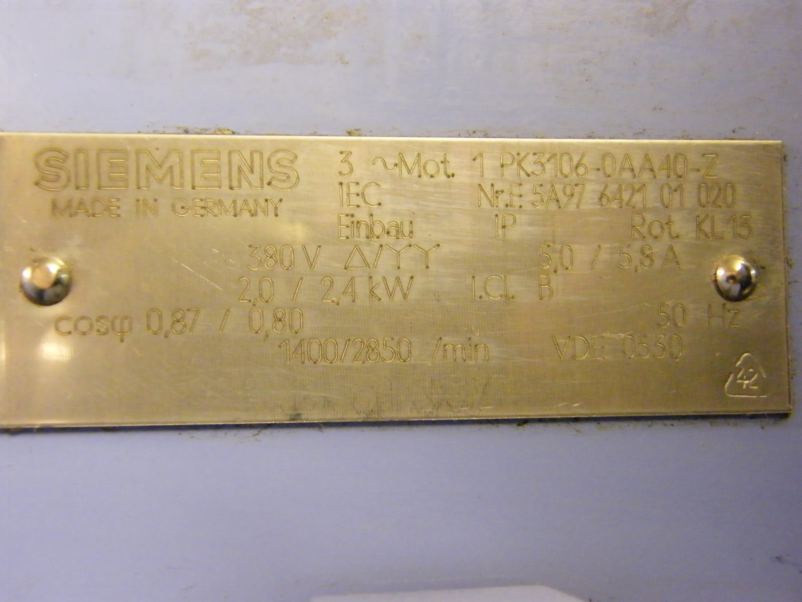

This is what I think will be the solution to get most out of speed range without too many gears/switches to handle.
Motor in Hi only for A and B in Hi/Lo gear ~1001 to 2500rpm
Motor in Lo for B to E in Hi/Lo gear ~80 to 1000rpm

27 Aug 2018 06:58 #116645
by tecno
Replied by tecno on topic Help needed to get my 7i76E + 7i85S + 7i73 on my mill going.
This compiles, but I would like to know what following lines actually does (as I think it is wrong).
pin in float gear.#.ratio[12];
motor_speed_out = spindle_speed_in * gear_ratio(gear);
As the spindle should go max at HI/LO motorspeed on each gear max and only adjust to min speed of that gear via VFD.

28 Aug 2018 07:24 #116704
Replied by andypugh on topic Help needed to get my 7i76E + 7i85S + 7i73 on my mill going.
The cases need to be 1, 2, 4, 8, 16 etc.
(Like the updated version that I posted, and gave you a link to).
Are you saying that you want to always run the VFD at 50 Hz?
The code that you have highlighted is intended to calculate the motor speed for the current spindle speed. as input it has a HAL pin where you need to set the ratio for each gear.
