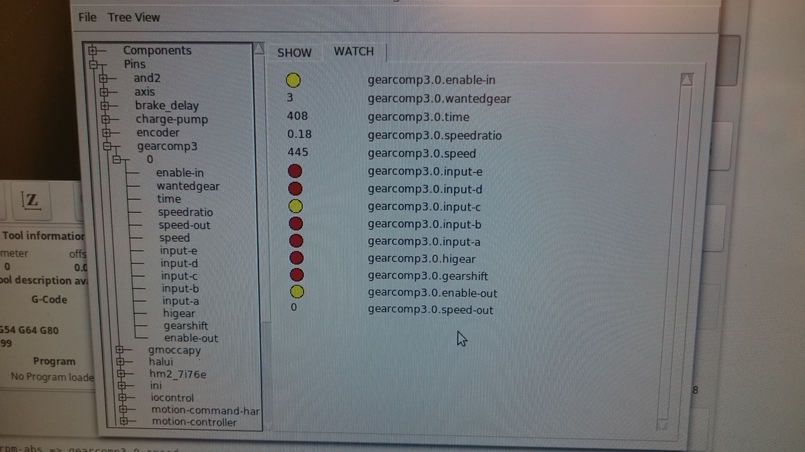

Something else must be set wrong, did test to edit speedratio but still nothing.
I can hear that motor relay is activated so it seems VFD is not getting any voltage from 7i76e output.

Ok, let's look at the screen.
You have input-c high which is third gear. gearcomp3 also wants you to use third gear so that is okay.
The speedratio is chosen to 0.18 which is fine for third gear. You have enable-in high and enable-out high, so the gearcomp3 clearly thinks you have the right gear.
But speed_out is 0.0. So there must be something wrong with the code you entered. Can you copy-paste the last if-statement in the component. I tend to think you placed the calculation of speed_out in the wrong place, setting it to zero when right gear is chosen and giving it a value when the wrong gear is chosen. But lets see.

PROGRESS
I think there is something wrong with speedratio that is shown as 0.18 and should be just about 1.0 or a bit less.
Some tweaking but what to change?

20 Aug 2018 13:08 #116379
by Hakan
From the figure in the previous post, speed_out is zero, so it should not run. See above.
Replied by Hakan on topic Help needed to get my 7i76E + 7i85S + 7i73 on my mill going.

20 Aug 2018 13:12 #116381
by Hakan
I moved the speed_out speed calculation to the right place. Now it should work. Remove the arrow.
if (inputs_sum > 0 && geartouse == gearengaged) { // Everything ok
gearshift = 0;
wantedgear = gearengaged;
speedratio = ratios[gearengaged-1];
enable_out = enable_in;
speed_out = speed/speedratio; <===============
} else { // Should change gear
gearshift = 1;
wantedgear = geartouse;
speedratio = ratios[geartouse-1];
enable_out = 0;
speed_out = 0.0;
}I moved the speed_out speed calculation to the right place. Now it should work. Remove the arrow.

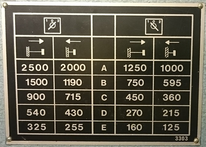

OK, it works but does not work correctly. S445 spindle is moving very slow due to speedratio.
first of all I have been misleading myself as well as you guys as regards rpm range.
This mill has a 2-speed 3-phase motor (Dahlander type)
So there is 2 ranges for the motor where now only the higher speed is active in my setup just now.
So in effect this gives 255 to 2500 rpm and if motor is switched to low speed 125 to 1250
So if I want the whole range I need to implement the low speed relay and I will do that as I want the whole range + some extra.
Honestly I don´t think if motor is in high speed to try to crank it down that much via VFD that I wanted is good for the motor as it surely will overheat.
So back to the drawingboard.
- Posts: 19908
- Thank you received: 4660
20 Aug 2018 16:43 #116388
Replied by andypugh on topic Help needed to get my 7i76E + 7i85S + 7i73 on my mill going.
Can I suggest reading about using VFDs with Dahlander motors?
There are things to consider. (One of which is that Dahlander-wound motors are generally quite old).
I think that it might work better to run the motor at 100Hz in low mode than 25 Hz in high mode.
If you choose to use both then you need to avoid re-arranging the windings with the VFD enabled.
