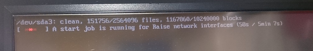

Both are 1e9
Well we know that the 7i76e has faults = spindle encoder inputs ( this have been discussed before and maybe some other too)
I am about to do a new install and skip that WiFi fix in grub as it slows down the boot.
Before this screen it takes few minutes and this part takes 1½minute = in total SLOOOOOOW

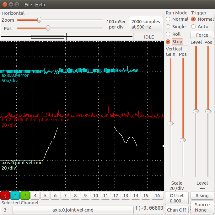

OK the main problem is in your hal file, you commented out all the stepgen feedback parts for the x axis...
To be clear, this part was commented out:
# ---closedloop stepper signals---
# net x-pos-cmd <= axis.0.motor-pos-cmd
# net x-vel-cmd <= axis.0.joint-vel-cmd
# net x-output <= hm2_7i76e.0.stepgen.00.velocity-cmd
# net x-pos-fb <= hm2_7i76e.0.stepgen.00.position-fb
# net x-pos-fb => axis.0.motor-pos-fb
# net x-enable <= axis.0.amp-enable-out
# net x-enable => hm2_7i76e.0.stepgen.00.enable
and should be
Here is the xaxis ferror with your config files (with a small tweak to FF2)
(50 u/div is not 50 microns/div but rather 50 nM/div since the machine scale is mm not Meters )
Also note that you had an error in the CNC3000enc.ini file, it pointed to the CNC3000.hal file, _not_ the CNC3000enc.hal file
