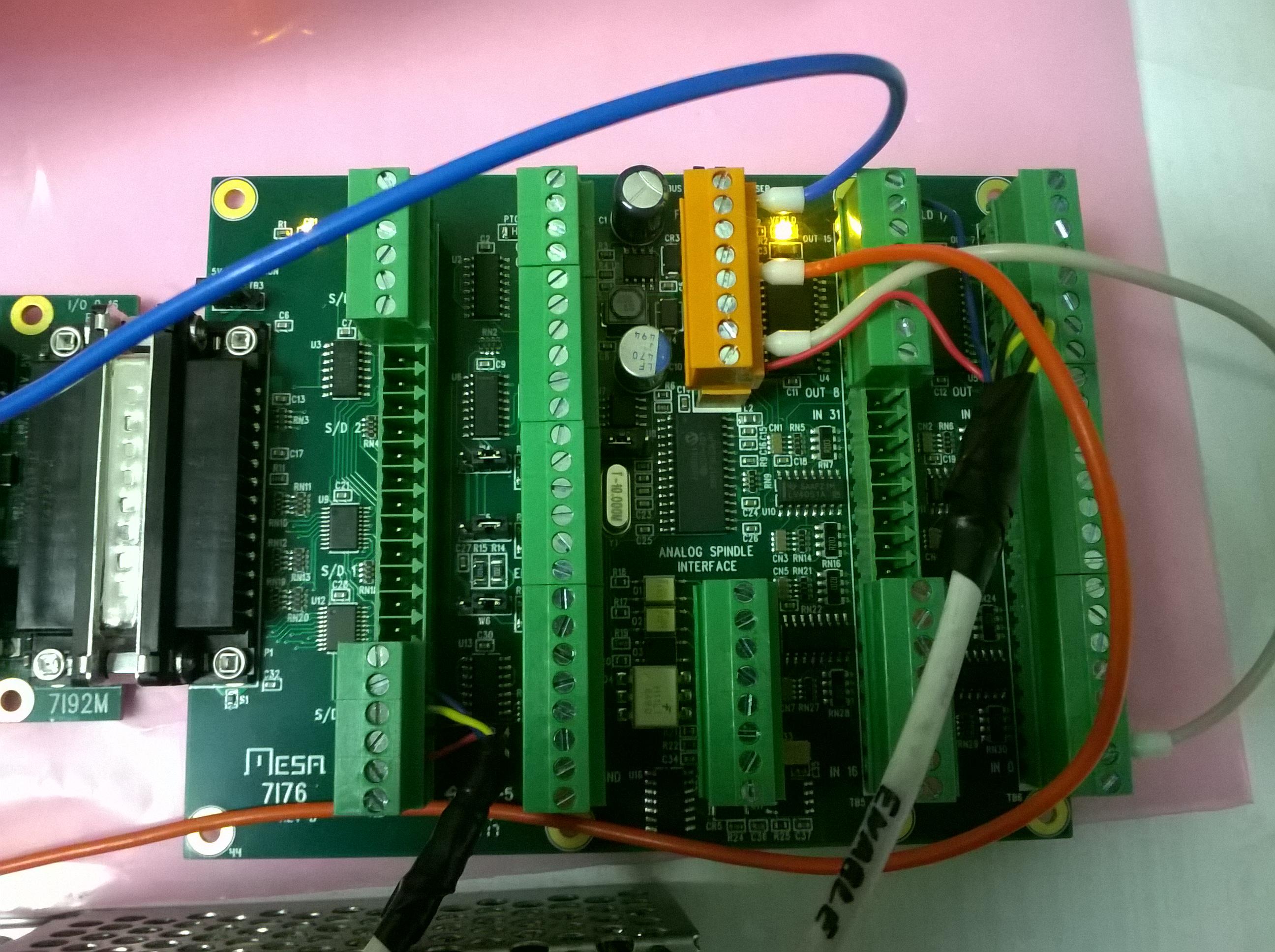

10 Feb 2018 10:16 #105712 by aleksamc
Replied by aleksamc on topic Configuration 7i92m_7i76x1D
Thanks for very!!! fast answer, PCW. I've perform your advice and that problems are out.
But I have another problems now))) Axes are not moving. I wonder, how to know if output board generates pulses at connected outputs if I don't have osciloscope? It could be problem with servodrive, but it's hard possible - they are was in work and everything was fine.
My servo drive (Maxsine EP1C) has monitoring parameter tat defines number of input pulses ( it's instead of osciloscope) but there is 0 and nothing change. Feed voltage is 5V.
It can't be low step/dir timing because step time is 1400ns in datasheet.
May be my outputs are not connected to needed inputs in hal.
As for "Enable input" - the driver see it fine.
My jumpers are in such positions:
7i92: w1 - up, w3: down , w4: up
7i76: w1 -left, w2 - left, w3 - left, w4-w6 - right.
Does somebody know what it should be?

10 Feb 2018 11:42 #105714 by PCW
Replied by PCW on topic Configuration 7i92m_7i76x1D
You can check the step outputs with a LED. You may set the steptime to a fairly high number
to see the LED light up (the dir pin is easy to check with a LED though)
Note that a LED across the step pins will light up brightly in one direction (use the other direction)

12 Feb 2018 03:47 #105783 by aleksamc
Thanks PCW, it was good idea to use LED.
I used them and saw that that pulses are present, but my servomotor doesn't see them.(((
I used steplen even 10000ns and stepspace 20000 but it's still blind.
I suspect that something bedwith that port on servomotor. May be I mixed up Step+ and step- in the past and broke some input.
12 Feb 2018 08:01 #105789 by PCW
it could also be a setup option on the drive
( many servo drives have a couple choices of motion command input )

13 Feb 2018 04:19 #105814 by aleksamc
Thank you, PCW, for yout attention a lot. I use standart motion command input: step - pulses to move, dir - direction of movement. It's the same as stepper motor.
Today I tried to connect enother servomotor. And got the same situation - encoder doesn't see step/dir signals. But must see, because this one is surely workable.
Mesa has some suspision habit. There is Step+ and step- singnals -. When there is no ethernet connection with linuxcnc, then voltage on this pins is 5V. But when I run linuxcnc, after initiating connection voltage inverts and at step+ pin there is 0V and at step- pin there is 5V - vise versa.
13 Feb 2018 08:38 - 13 Feb 2018 08:39 #105822 by PCW
This is normal and happens because the idle state of the FPGA pins is high. so before startup and after shutdown (or watchdog bite)
the pins at the FPGA will be at a high state so the + pin will idle high and go low when LinuxCNC starts. This should have no effect on your drives but you can change this behaviour if desired by inverting the step outputs in the hal file.
If your drives do not respond to a step input, it suggests a setup or wiring error of some kind
