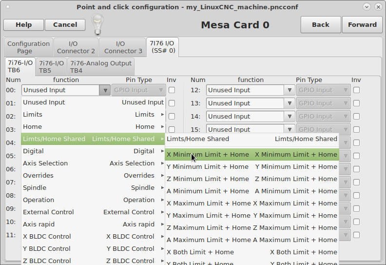

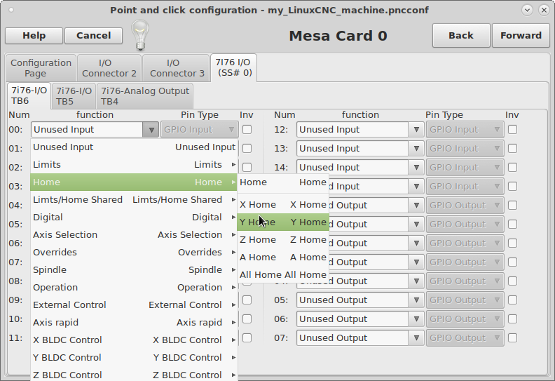

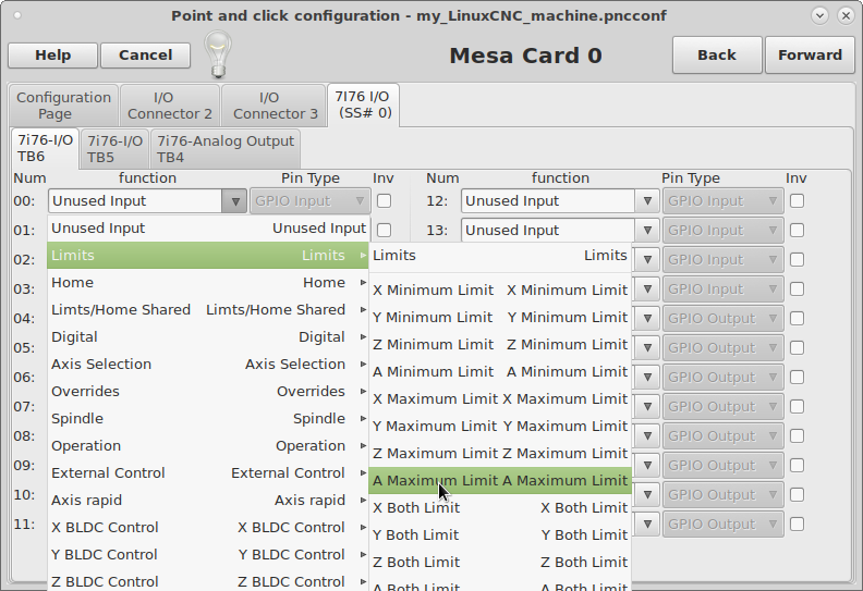

I have in my configuration hal file
"net both-home-x <= hm2_7i92.0.7i76.0.0.input-07"
I choused that because there is no separete choice.
But I need separate minimum limit (could be for X Y and Z), maximum limit and separate home for each.
What I need to write in my hal file?
MESA 7i76 also has analog spindle Enable+, Enable-, Dir+, Dir- outputs. Does they support 24V?

There is nothing "magic" about the name "both-home-x", it could be called anything.
If you look elsewhere in the HAL file you will probably find that somewhere there is something like
net both-home-x axis.0.neg-lim-sw-in axis.0.pos-lim-sw-in axis.0.home-sw-in
(May be split over several lines)
To do them separately you cold have:
net red hm2_7i92.0.7i76.0.0.input-07
net blue hm2_7i92.0.7i76.0.0.input-08
net yellow hm2_7i92.0.7i76.0.0.input-09
net red axis.0.neg-lim-sw-in
net blue axis.0.pos-lim-sw-in
net yellow axis.0.home-sw-in
Or any variation on that theme.
