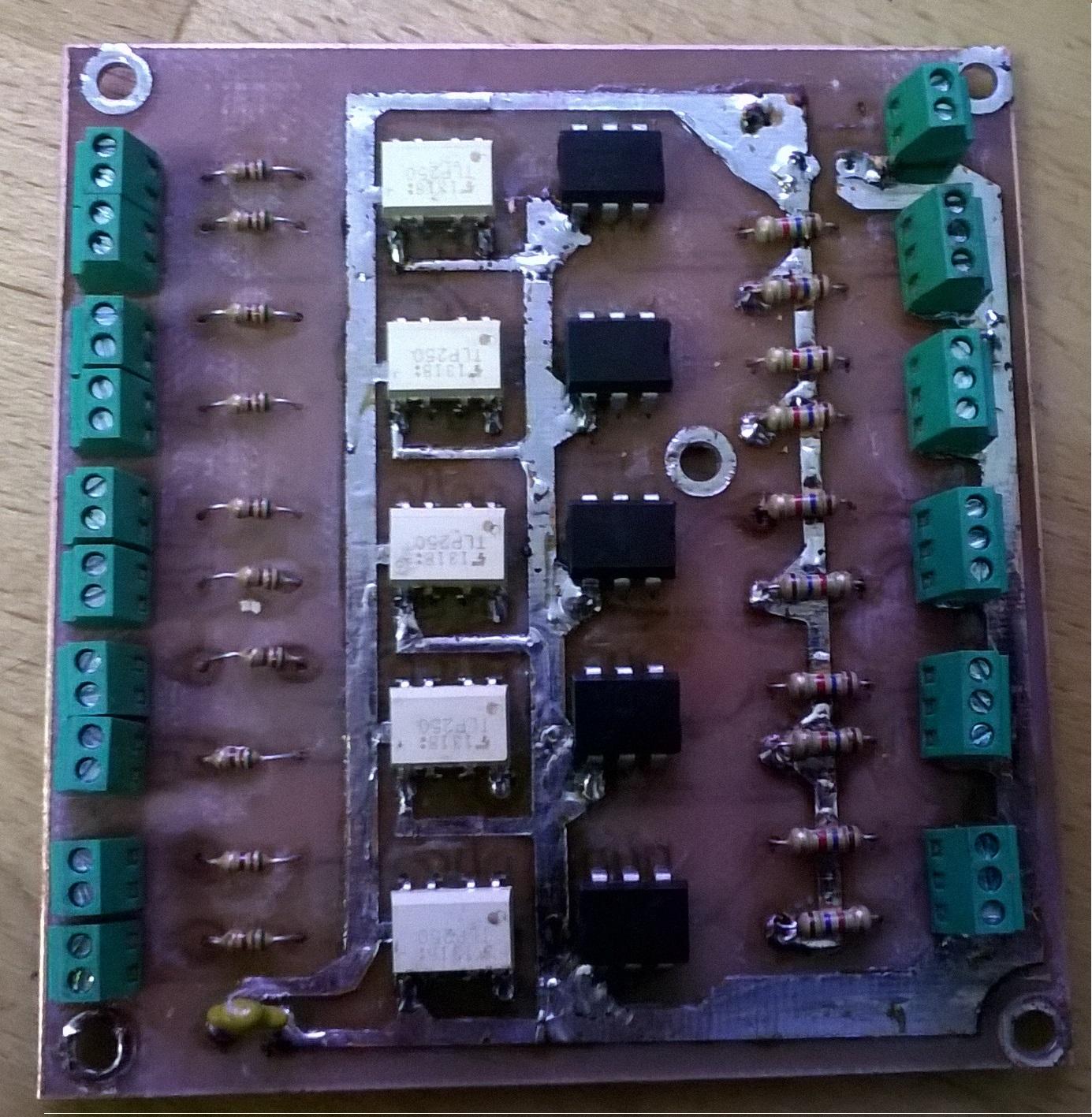

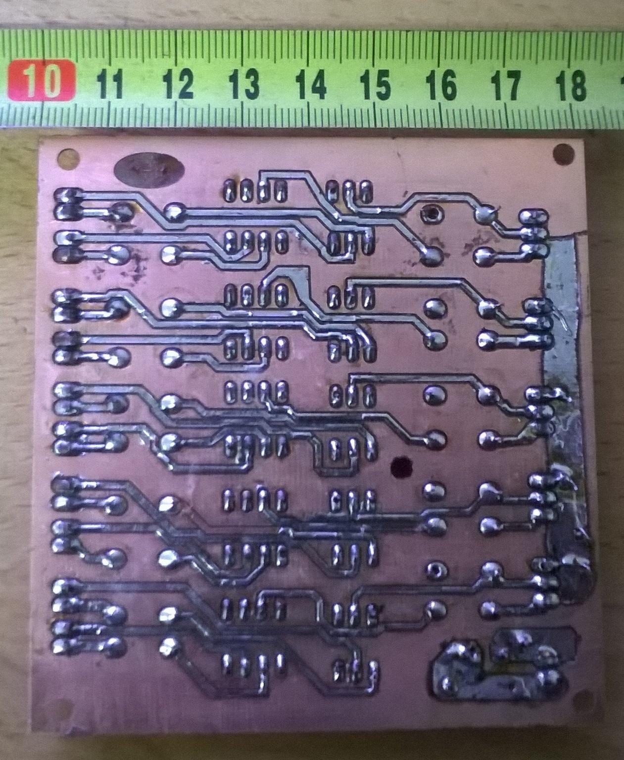

27 Feb 2018 09:31 #106624 by aleksamc
Replied by aleksamc on topic Configuration 7i92m_7i76x1D
I've finished my "5V to 24V" transmitter for 5 chanels and it works fine.
For step signal I use TLP250 - high freaquencu optocoupler and for Dir signal I use cheap and "slow" 4N27 transistor optocoupler.
I also have problems with only one X axis (port 0). It has big ripple. It's so big that I see that direction changes 7-10 times. I've also connected diode to MESA 7i76 output to check if problem in my pcb or MESA
File Attachment:
File Name: MachineCNC...2-27.hal
File Size:20 KB
File Attachment:
File Name: MachineCNC...2-27.ini
File Size:5 KB
. Ripple goes from MESA side. It seems that problem in PID requlator. But parameters for X, Y and Z are same. I attach also Hal and ini files. Please look them. I think that problem in configuration files.
