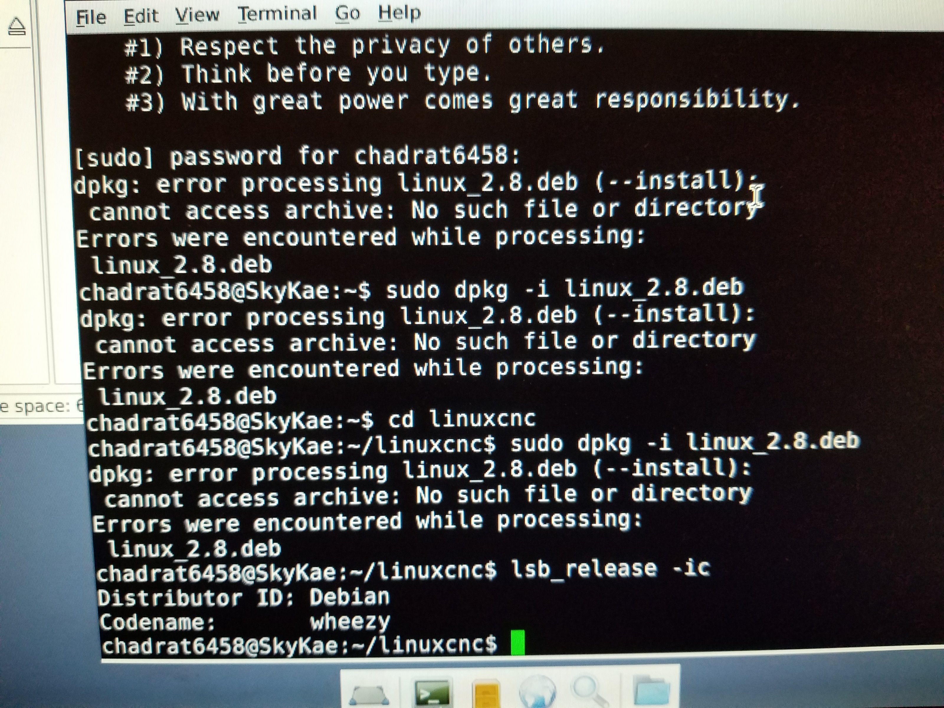

- chadrat6458
- Posts: 45
21 Feb 2018 15:38 #106293
by chadrat6458
Replied by chadrat6458 on topic 2 steppers on one axis 5i25 - 7i76
How do I get 2.8?

- chadrat6458
- Posts: 45
21 Feb 2018 16:53 #106297
by chadrat6458
