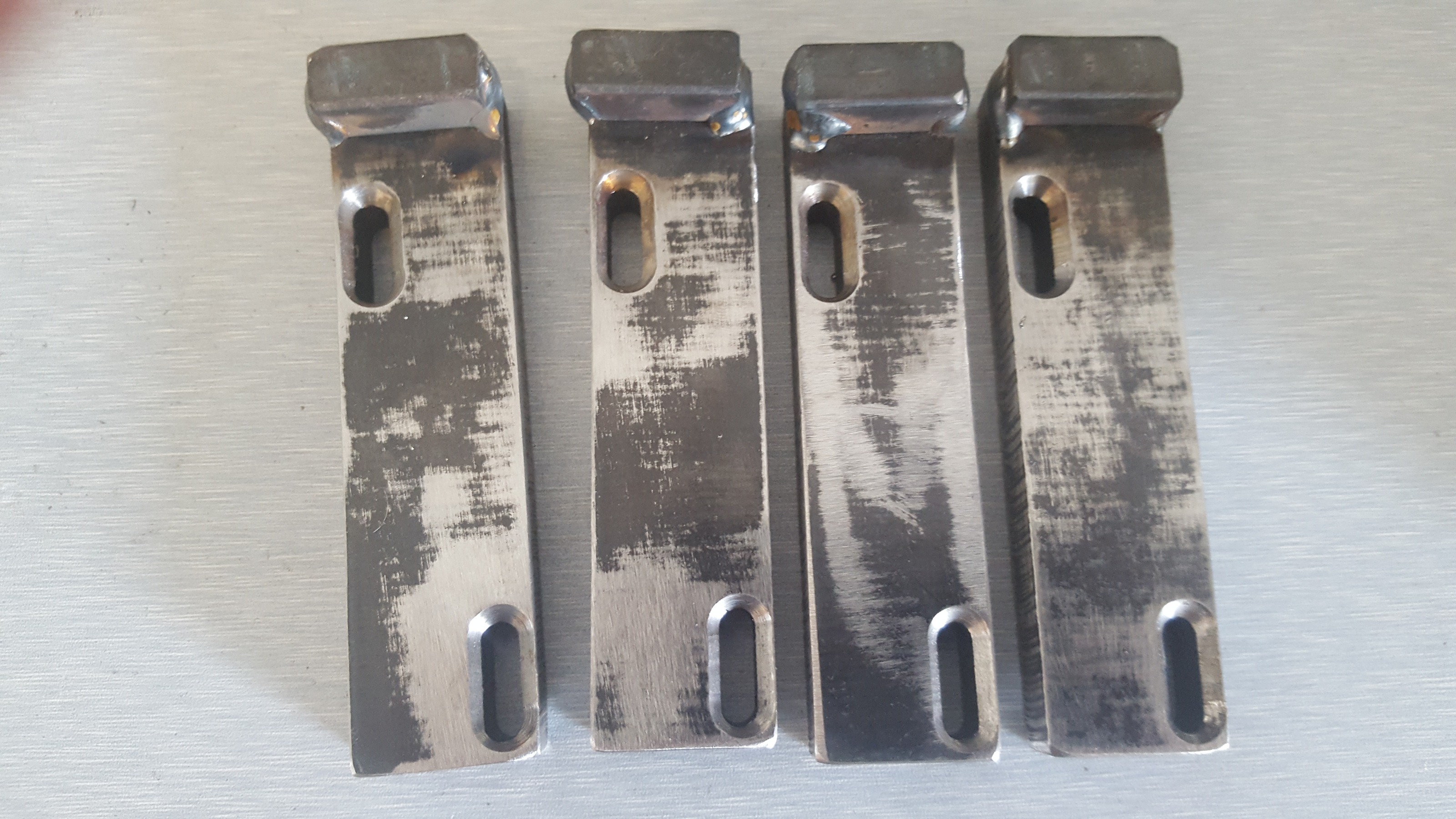

Yup, that was it. I have attached my .hal and .ini files.
I made the HOME_SEQUENCE for the X and Z equal to 0. The Ys got -1.
Time to come up with some cool proximity sensor brackets. I will probably mess around with my spindle too.
Thanks guys for all your help.

Replied by rodw on topic 2 steppers on one axis 5i25 - 7i76
Just be aware that the home switches need to stay closed until the axis slows to a stop. I allowed 100mm for this and came up with a combined home/limit switch accuator
The home prox sensor senses the lower flat plate and the limit prox sensor is mounted higher so it is triggered by the 10mm block welded on.
