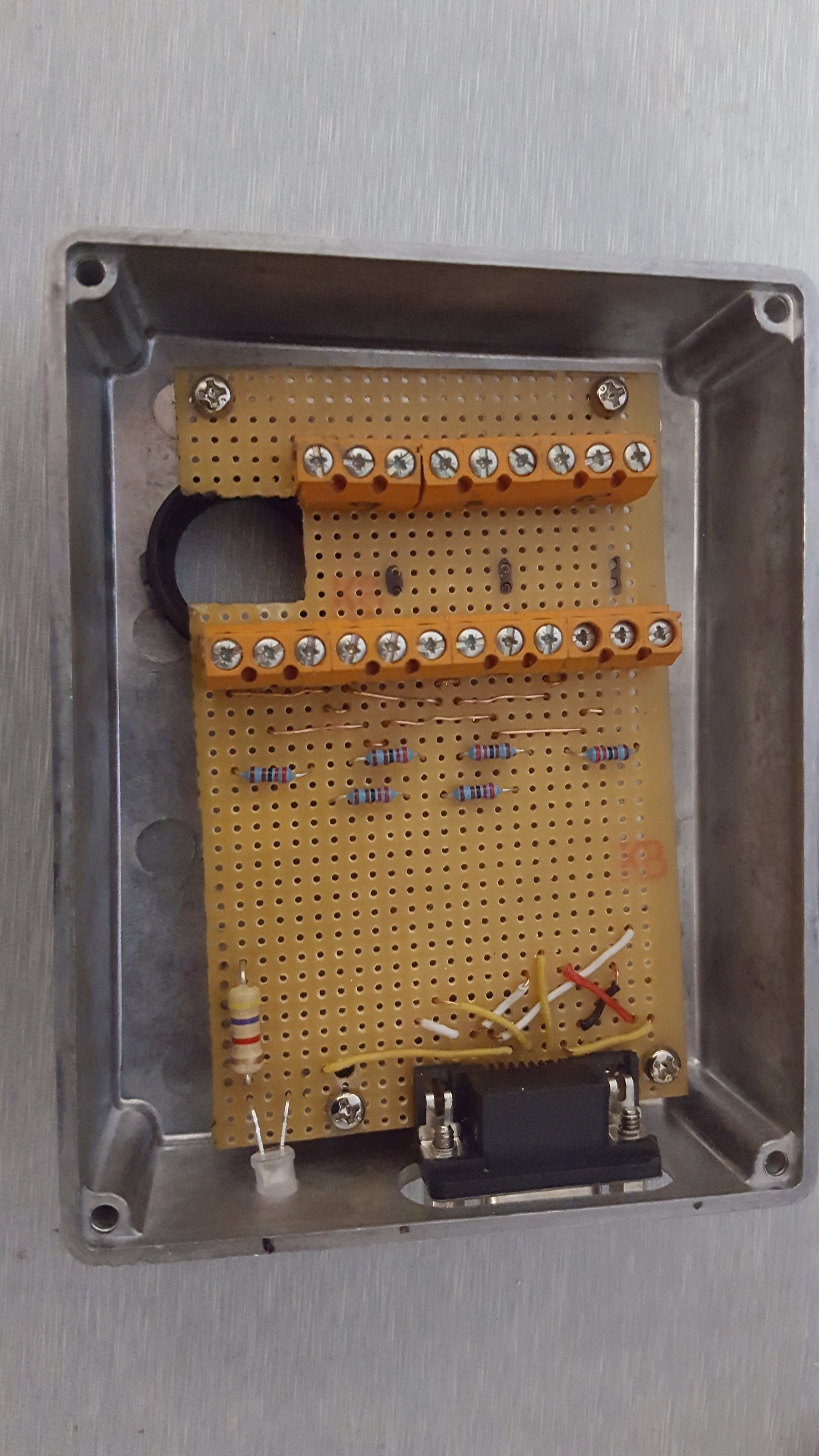

I have some Proximity Switch NPN to use for home/limit switch. Do you guys have any tips on how to wire them up?

On Mesa boards, PNP are the preferred type -- but both me and Rodw have rigged ours with NPN. And by me and Rodw I mean, he did it and I copied him
It requires a pullup resistor. PCW's guidance on the thread below clarified it for me:
forum.linuxcnc.org/27-driver-boards/3191...sheet?start=10#91557

Is this what I need?
2k 1/2w resistor
I hook this up between the power side and the output side of my switch?
2k 1/2w resistor

I used these: www.arrow.com/en/products/rs01a2k000jb12/vishay
Rodw used a circuit board for his, but I just soldered mine in as a T-splice to the sensor wire before it gets to the input pin. Page 7 of Norbert's holy gospel of 7i76e configuration has a schematic: forum.linuxcnc.org/27-driver-boards/3191...t?limitstart=0#83622

I checked my notes.I used 2.2 k ohms, 1 W on a 24 volt system.
I always intended to use a board as I had so many switches on the gantry it was convenient to use a DB9 cable and distribute to terminal blocks so I had the room to add the resistors which made it real easy to implement.
