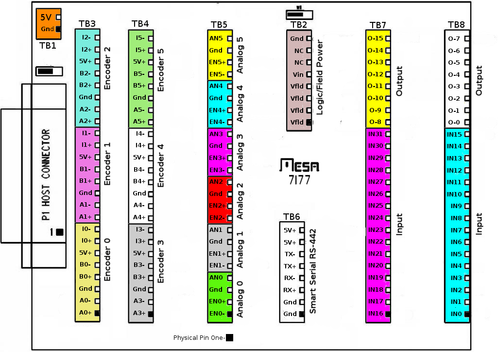

12 Mar 2018 15:37 - 12 Mar 2018 22:42 #107247
Replied by cmorley on topic pncconf - feature requests
pic removed - because it was wrong.
Could someone please confirm my work is correct?
Mesa 7i77 card
Chris M
Mesa 7i77 card
Chris M
Last edit: 12 Mar 2018 22:42 by cmorley.

12 Mar 2018 17:16 #107250
Replied by Todd Zuercher on topic pncconf - feature requests
Looks wrong to me.
Pins on individual encoder plugs are reversed.
Analog outs are switched with the enables.

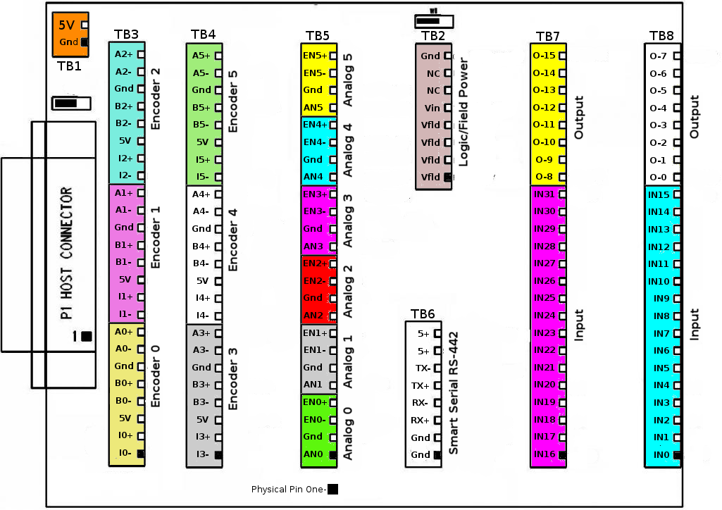

12 Mar 2018 22:38 #107266

23 Feb 2019 15:06 #127008
by pl7i92
Replied by pl7i92 on topic pncconf - feature requests
what mesa Card is th image off @cmorney
i guess its a Mesa
Please Can you Write it at the Image
i guess its a Mesa
- Posts: 21895
- Thank you received: 7465
23 Feb 2019 19:57 #127017
Replied by tommylight on topic pncconf - feature requests
7i77 as noted above.
- Posts: 7361
- Thank you received: 2173
23 Feb 2019 23:59 #127026
