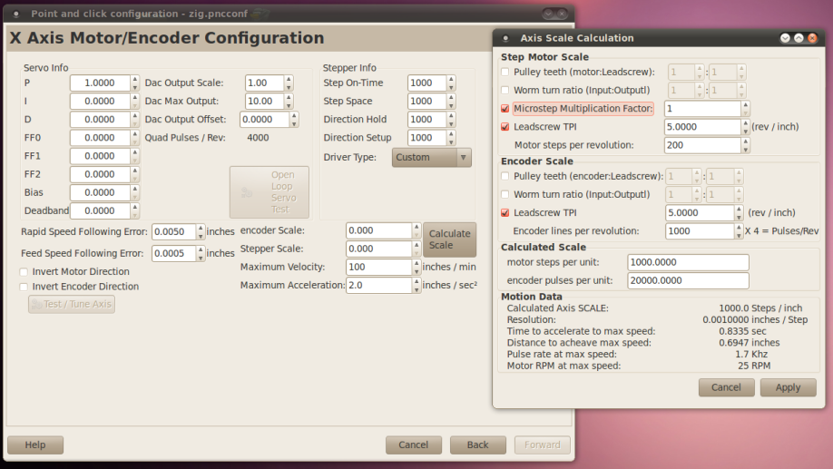

If you know the scaling great other wise can you give me as much info
in the axis scale screen shot as you can / appropriate.
And how do you control your spindle.
i could make a sample config.
I need some info though.
i need to know the stepper and encoder scaling.

image missing http://www.linuxcnc.org/media/kunena/attachments/legacy/images/axis_scale.png
