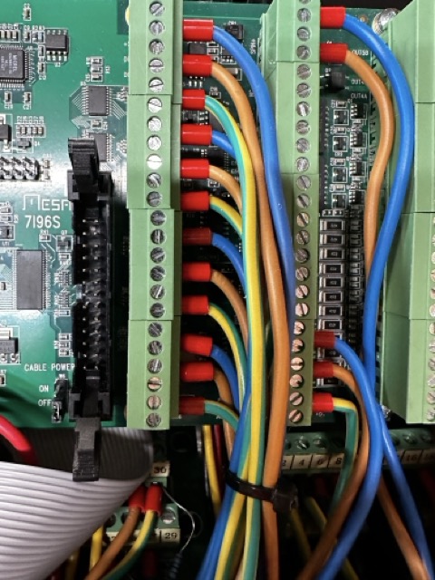

Replied by moretoyswins on topic Can not get stepper motors to move with Gecko g250x drivers
So tested my led configuration against the ground and 5v terminals TB1-1 and TB1-6 and it glows. But I get no indication of light when connected to TB1-1 and TB1-3 but I do get light connected to TB1-1 and TB1-2.
So, any ideas what I have wrong in the board config to cause that?
Thanks!
Thanks!

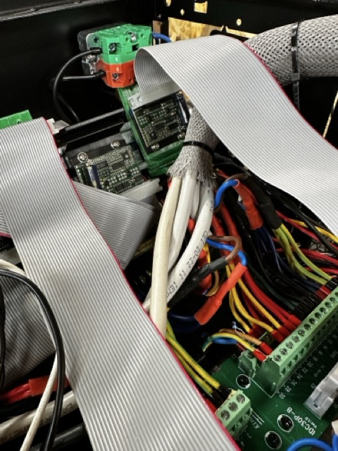

- Posts: 21986
- Thank you received: 7487
23 Apr 2024 00:28 #298878
Replied by tommylight on topic Can not get stepper motors to move with Gecko g250x drivers
How are the Geckos wired to Mesa? Picture?

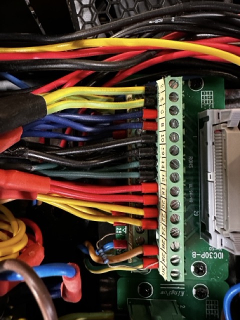

- moretoyswins
- Posts: 38
23 Apr 2024 01:00 #298880
by moretoyswins
- Blue wire is Direction connected to TB1-5
- Light Brown wire is Step connected to TB1-3
- Yellow/Green wire is Ground connected to TB1-1
- Blue wire is Direction connected to 30p Terminal Block pin 27
- Light Brown wire is Step connected to 30p Terminal Block pin 28
- Yellow/Green wire is Ground connected to 30p Terminal Block pin 30
30 pin ribbon cable connections to G250X
- Posts: 18105
- Thank you received: 5328
23 Apr 2024 01:07 #298881
Replied by PCW on topic Can not get stepper motors to move with Gecko g250x drivers
You should get a DIM glows from and LED connected from GND (TB1 pin 1)
to STEP0+, (Cathode on GND) but only when you jog X.
I would expect and LED connected to STEP0- (TB1 pin2) and GND
to glow brightly all the time as STEP0- will be high most of the time and
only go low when a step pulse occurs
You should be able to reverse the roles of STEP0+ and STEP0-
by inverting the step output. You can do this live with halshow
(Machine --> Show Hal Configuration) and setting:
hm2_7i96s.0.stepgen.00.step.invert_output
true
true
