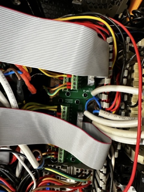

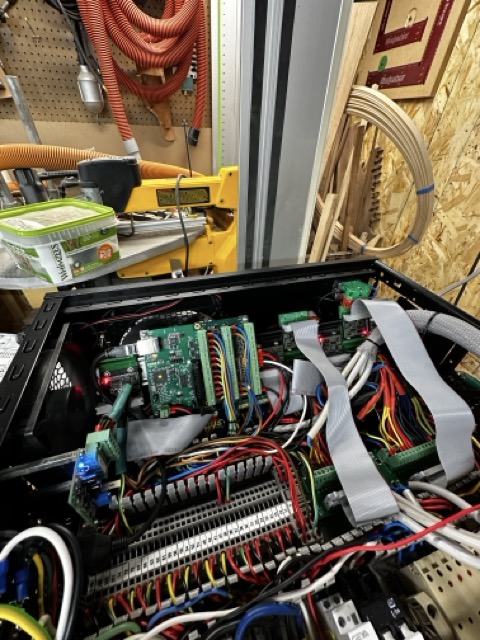

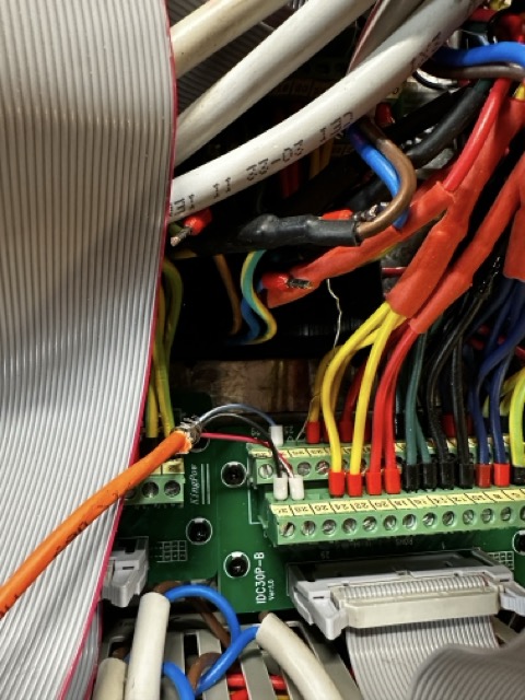

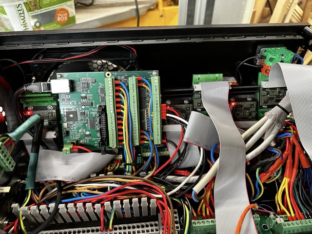

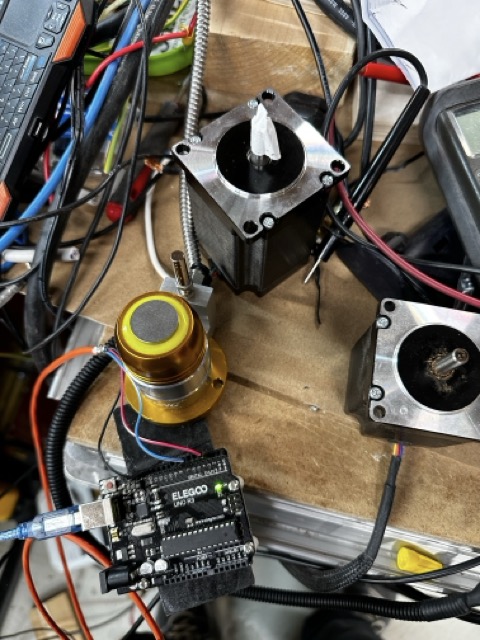

No, as I tried to convey I am literally changing 3 wires to switch between the 7i96s and Arduino, let me switch and send a couple of pictures.

If possible I am more confused. I was trying to measure voltages while the Arduino was driving. The motor only turns in a CW direction, when CCW is requested it does not turn.
Also, because the signal ground comes from the Arduino the stepper is turning very slowly, but if I try measuring voltage from signal ground to any phase the motor speeds up, am I shorting something trying this?
