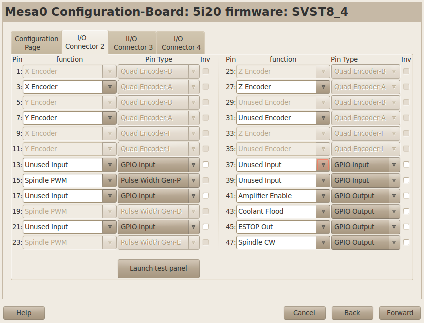

02 Apr 2011 03:53 #8380
developing a stepper with encoder config was created by cmorley
This continues zig's offer of testing a sample config (check out feature requests)
So a basic XYZ METRIC machine.
Leadscrews are 5 mm pitch.
Servo motors are directly coupled to the screws.
Linear scale has a basic resolution of 20 micron but in quadrature mode the resolution is 5 micron.
The reader head on the scale outputs an Index pulse for homing as well as an end of travel flag ( a single flag for both positive and negative limits).
Zig what is the stepper drive timings?

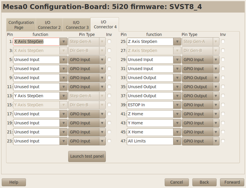

Chris,
Back on task.
Going through the readme file and looking at pin assignments:
MESA connector 4 pins #20,21 and 22are labeled home-z , home-x and home -y I take it these are home signal inputs.
However...
MESA connector 2 pins #4,5 and 16 are labeled x-encoder-i, y-encoder-i and z-encoder-i index signal inputs used as homing signal inputs by hostmot2 .
What is the difference between these two groups of pins?
Back on task.
However...

- Posts: 7967
- Thank you received: 2167
13 Apr 2011 07:51 #8827
Replied by cmorley on topic Re:developing a stepper with encoder config
the home switch eg home-x is for actual switches.
Usually these are course position switches used with rotary encoders since they have an index pulse every rotation and you need to let EMC know when your close.
The x encoder index is from the encoder for precise home position.
But I guess in your situation you don't need the home-x course switch inputs as you have only one index for home.
