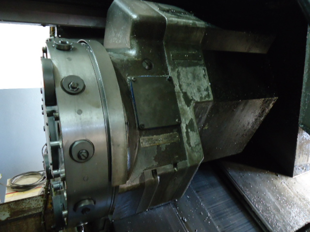

not sure if your lathe has the tool on the back side but there is currently work on the graphics plot to show that properly (not by me).
Chris M
31 Jan 2013 19:31 #29359 by emcPT
Were is the toolholder. I suppose that it is more than 350Kg, but I am not sure.
The toolholder is after the center line (X0) in the operator point of view like most CNC lathes, so I am not sure if you were refering about this situation when you said "tools on the back"
And this is showing the remaining body of the tool holder. The disk have about 550mm diameter (22")
I would really like to make this good iron machine to work with linuxcnc. I am trying to convince the remaining people here to invest a bit in I&D and hire a worker just for this.

01 Feb 2013 09:17 #29417 by cmorley
Replied by cmorley on topic Gscreen - a GTK / Glade / Python based screen
This has the tool turret in the back.
so looking at the end on the lathe looking at the chuck the tool turret is on the right side.
linuxcnc displays it on the left side looking as above or front if standing in the usual place.
There is some work arounds and work going on to fix this.
