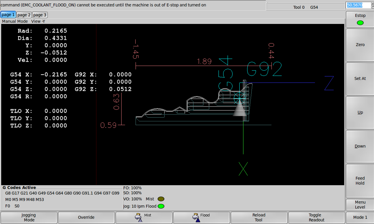

19 Feb 2012 01:06 #17811
Replied by cmorley on topic Re:Gscreen - a GTK / Glade / Python based screen
gscreen patch to go against current as of now master.
adds fullscreen (not maximize - all of it!) capability
adds an embedded terminal for call debugging programs.
adds an option to use aux coolant instead of mist or flood
this was requested by my only tester cncbasher, it requires one to connect HAL to gscreens coolant pins instead of linxcnc's
fixed save and save-as for gcode edits.
probably some other stuff

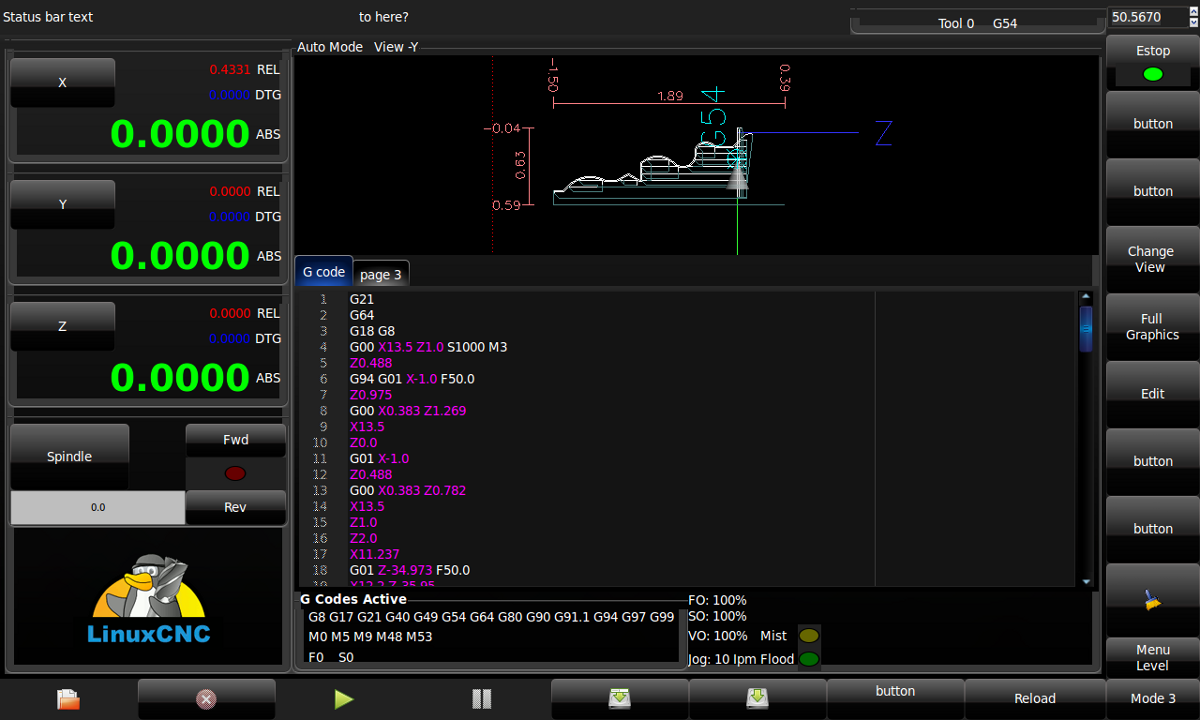

- cncbasher
- Posts: 1021
- Thank you received: 202
19 Feb 2012 11:53 - 19 Feb 2012 11:55 #17825
by cncbasher
Replied by cncbasher on topic Re:Gscreen - a GTK / Glade / Python based screen
just about to take the step now of configuring without axis , for the first time , so jumping without a safety net ! ( only figuratively thank god )
but all seems to fit in well , touch screen is working fine , no difficultys selecting etc .
now a machine on togglebutton , with colour change red / green so you can see status perhaps
needs to be i think on the right side under the estop , or perhaps top left next to status .
in a similar style to the estop and led i think would suit better
Last edit: 19 Feb 2012 11:55 by cncbasher.
