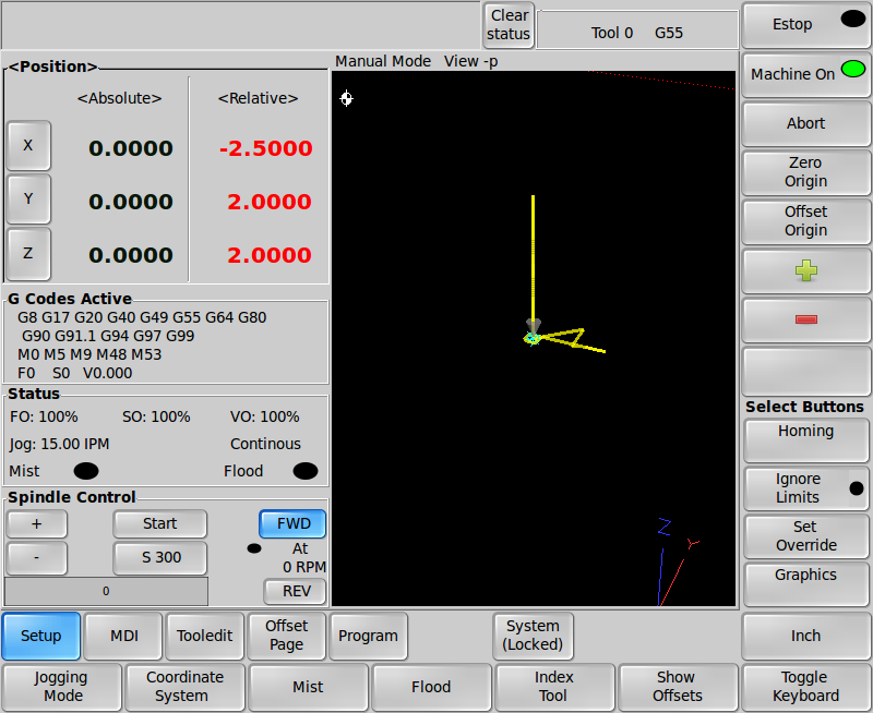

Sample of bottom buttons for industrial:
The following user(s) said Thank You: BigJohnT, tjamscad

18 Feb 2013 17:51 #30270 by cmorley
Replied by cmorley on topic Gscreen - a GTK / Glade / Python based screen
An interesting idea. It still doesn't fix the mode switching problem.
I have enough work as it is ! :)
