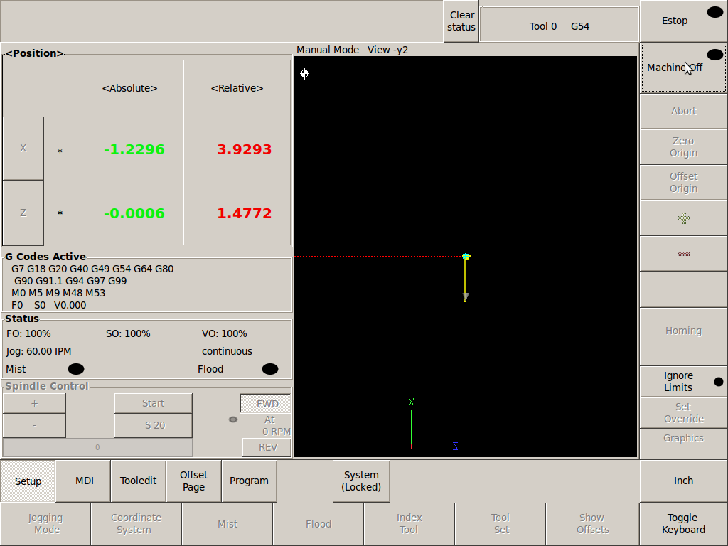

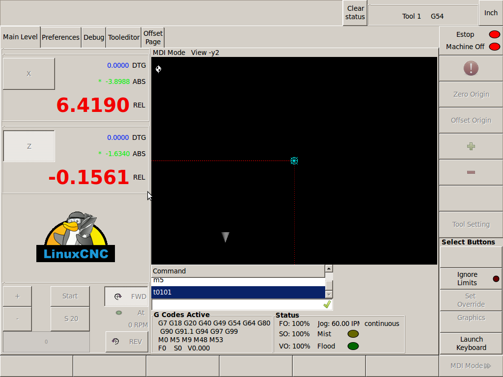

Hello Chris,
I don't know if I stumbled on this on accident, or if its supposed to be, but does this screen look right?
After a little snooping around I realized that "Industrial" should look like this,
I'm thinking that it isn't right,
Although I do like it,
Also, in the actual "Industrial" skin, shouldn't the "Diameter Mode" button in the preferences change the relative readout to correspond with diameter or radius, I know that in the "hybrid" as I would call it, and have actually been using on my first Gscreen machine, it does change the relative readout for the X. In "Industrial" it stays as the radius value in the "setup" mode.
Thanks,
Rick

Replied by cmorley on topic Gscreen - a GTK / Glade / Python based screen
The first screen is 'default skin' Gscreen set up for a lathe.
Second is 'Industrial skin' Gscreen looks like for a lathe too.
Yes the Diameter mode should change the relative readout - it's a bug you have found.
I'll look into it.
Chris M
I'll look into it.
Chris M
