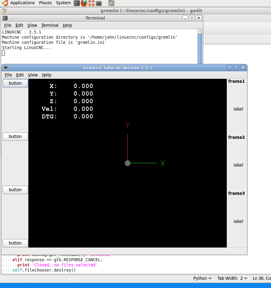

I'm attempting to load gremlin into my GUI at run time with this:
import linuxcnc, hal, gremlin
self.grem = gremlin
self.plot.pack_start(self.grem)
self.plot.reorder_child(self.grem, 1)
And I get this error:
File "/usr/bin/gui7", line 41, in __init__
TypeError: Gtk.Box.pack_start() argument 1 must be gtk.Widget, not module
I successfully loaded a label into the correct spot so I know that much is ok.
More guessing and now I get this:
self.grem = gremlin.Gremlin()
TypeError: __init__() takes exactly 2 arguments (1 given)
Even more guessing and now I get this:
File "/usr/bin/gui7", line 40, in __init__
self.grem = gremlin.Gremlin(self.plot)
File "/usr/lib/pymodules/python2.6/gremlin.py", line 81, in __init__
self.get_geometry()
File "/usr/lib/pymodules/python2.6/gremlin.py", line 245, in get_geometry
temp = self.inifile.find("DISPLAY", "GEOMETRY")
AttributeError: 'gtk.HBox' object has no attribute 'find'
Exception AttributeError: "'Gremlin' object has no attribute '_dlists'" in <bound method Gremlin.__del__ of <Gremlin object at 0x9e725cc (GtkDrawingArea at 0x9f10858)>> ignored
I think I'm making progress but don't know... not sure what the AttributeError is about...
John

Ok, I think I spotted something. The Gremlin class init needs the path to the ini file... now to figure out how to supply that.

John if you look at hal_gremlin this might help you do what you wish.
Hal_gremlin is a "wrapper' around gremlin so it can be used in gladevcp.
for instance here is how it creates an instance of gremlin:
def __init__(self, *a, **kw):
inifile = os.environ.get('INI_FILE_NAME', '/dev/null')
inifile = linuxcnc.ini(inifile)
gremlin.Gremlin.__init__(self, inifile)
self.gstat = GStat()
self.gstat.connect('file-loaded', lambda w, f: self._load(f))
self.show()
it get the inifile info and calls gremlin init directly
after that it creates an instance of GStat and connects it to self_load to automatically load the current program.
GStat is a object that keeps track of some of linuxcnc's info and emits signals based on them.
Not sure if that helps you. It's all a bit above my complete understanding - so I have to do a lot of testing too!

I tested this in Gscreen it worked:
accel_group = gtk.AccelGroup()
accel_group.connect_group(ord('q'), gtk.gdk.CONTROL_MASK,
gtk.ACCEL_LOCKED, gtk.main_quit)
self.widgets.window1.add_accel_group(accel_group)
self.widgets.window1 is my reference to the main window
changing gtk.main_quit to any other callback should work fine too
Chris M

Real quick testing keeps giving me errors but looking at gremlin-run I think I see some hints there...

19 Dec 2012 22:47 - 19 Dec 2012 22:50 #27866
by BigJohnT
Replied by BigJohnT on topic Gremlin
Last edit: 19 Dec 2012 22:50 by BigJohnT.
- ArcEye
- Posts: 24
- Thank you received: 758
19 Dec 2012 23:19 #27867
by ArcEye
Replied by ArcEye on topic Gremlin
Well done - persistence wins out
If you want to reduce the size of the font and lose the DTG reading to increase visibility, the options are in gremlin.py
I hard coded them but you probably can change the properties from code.
