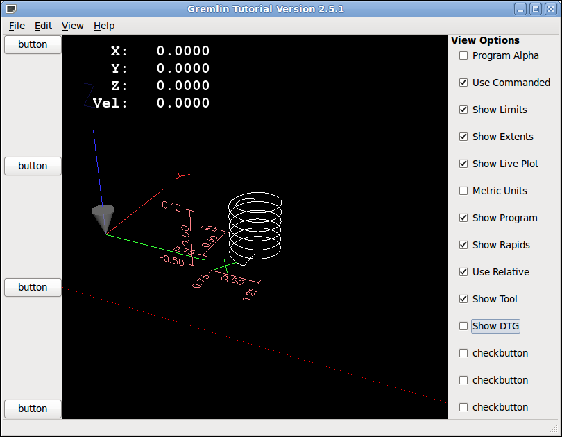

A screenshot of what I have so far
I can change all the view options and they work. I can change the view from the menu to X, Y, Z or Perspective. I can open a file and it will display. Working on the error part and I just had a thought on that...
John
