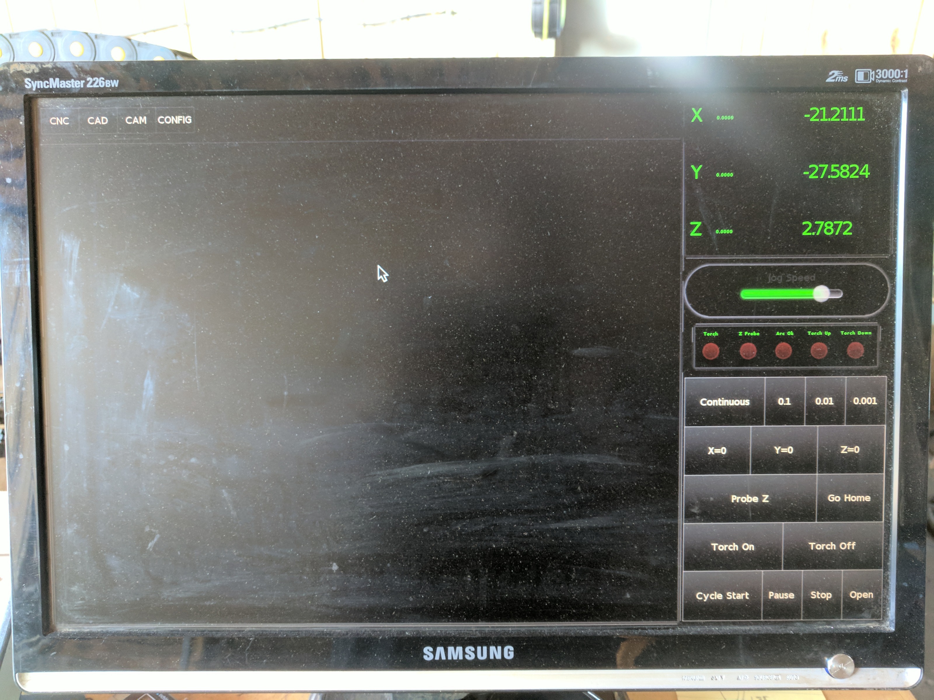

Hello,
I'm working on a GUI written in C that outputs directly to the frame buffer and requires no dynamically linked GUI libraries. (Works without X). I own a company that manufactures CNC plasma cutters and we would like to develop what we are calling our Gen2 control that is completely embedded (A single circuit board that includes Linux SOC, stepper drivers, power supply, aux inputs, aux outputs, analog inputs, etc). I've read some posts around here with some folks mentioning that these embedded systems are "toys" and I agree to the extent that most readily-available embedded systems like Rasberry Pi or BeagleBone are not an industrial duty system at all and not meant to operate in industrial conditions. I want to note here that our "Mainboard" has been developed in-house and is *very industrial*. Having a single board is very attractive to us for several reasons but mostly because it will allow us to support our hardware under a direct replacement warranty and not have to troubleshoot between control wiring, drivers, interface board, and external computer hardware issues...
We would like to release this GUI as open source and it will be compatible with virtually any architecture that Linux has been ported too, Raspberry Pi and BeagleBone are included in that. It will include a "CAD & CAM" module that will integrate into our cloud-based CAD/CAM system (Will also work offline, just without cloud access to drawings and job files) so drawing parts, creating toolpaths, and posting Gcode can all be done without leaving the GUI, or open Gcode files posted from other CAM systems...
Right now I have a working DRO, indicators for some inputs, and jogging working. I have these working by using "system" commands to interface to halcmd. This is not a great solution but I seem to be having a hard time finding documentation to interface to the rtapi via C. I know the python bindings are written in C so this should be fairly straightforward.
Is there anyone here with in-depth knowledge of the rtapi that would be interested in helping a little bit with this?

Looking at the (no longer included, but very simple) emclcd GUI, that seems to do jogging by #including shcom.hh
github.com/LinuxCNC/linuxcnc/blob/2.6/src/emc/usr_intf/shcom.hh
For example, here it jogs axes by using sendJogCont:
github.com/LinuxCNC/linuxcnc/blob/2.6/sr...intf/emclcd.cc#L1134
The basic interaction mode in LinuxCNC is NML messaging, and shcom seems to be an easy way to do this (if C++ headers are valid in a C file)
Looking at the documents, though, it seems to say that one should use motion.h
www.linuxcnc.org/docs/2.7/html/code/code-notes.html#_commands
And looking at the file, it does seem to contain all the commands that a GUI would need:
github.com/LinuxCNC/linuxcnc/blob/2.6/src/emc/motion/motion.h

andypugh - Thanks for the quick reply!
I looked through everything you pointed me too but I'm still not sure how to attack this.
shcom.hh is not available at /usr/include/linuxcnc
motion.h is and my code compiles with it included but I'm not sure where to go from there because motion.c doesn't seem to include any functions to init NML and send messages.
I'm linking with -lnml which seems to work but I haven't found any documentation on how to use libnml.
Right now my approach with halcmd and popen works. Is there a way I can turn off estop and enable machine power from halcmd?
Also is there a way to pump g-code into linuxcnc via halcmd or another terminal program? Maybe I can stick with this approach

Hi Travis,
Join the forum. I hope you can bring knowledge and bring linuxcnc to higher market level.
Wich company do you own? Microstep, Swiftcut or maybe Purelogic?
G-code is done by the g code interpreter only. It's a block of linuxcnc.
E stop and power on in linuxcnc simulation mode can be done with keyboard shorcut's like F2 & F3 or via touch screen or
screen select with mouse click. If you have custom gui, you have to do keybindings.
My advise is, look at the gnipsel gui. For me it's almost impossible to write linuxcnc in C in one lifetime.

I think that you might need to subscribe to the developers mailing list to get answers to the sort of question that you are asking.

andypugh - I may subscribe to the mailing list later on but I think I figured out a good solution.
grotius - I'm going to send you a PM, I don't want to use this forum to advertise my company.
I found a solution to my questions. I'm going to use the python library to execute python code from inside the C code of my GUI. It seems funny to go C GUI->python->C python bindings->LinuxCNC when I could just go C GUI->LinuxCNC but right now the python interface is pretty well documented so I'm going to go this route for now. It seems to be working well, I'll make the Github repository public once I have a GUI up and running.
Thanks!

It would probably make more sense to make a thin shim layer between your C and the C++ API.

I agree but the documentation is really hard to get through and come up with something that works. If you can come up with an example of c++ code that uses includes from /usr/include that initiates an NML interface and speaks of how to actually send commands across I'd love to see it but I've already spent 10 hours today digging and I'm empty handed. The python method is a little bulky and is now the only externally linked library my gui needs in order to compile, so I would love to ditch this method.

Here a example how to :
emc-users.narkive.com/44bLaS4j/controlli...nally-with-c-program
Provided by the Bird, 5 years ago.
What i found important in this conversation :
Halui will be the most usefull to start with i think.
The source code of Halui.cc :
github.com/michelwijnja/external_offsets...mc/usr_intf/halui.cc
If you change this file in your application, you can test your connection's quite easy.
Halui pins : linuxcnc.org/docs/html/man/man1/halui.1.html you can use them with the halcommand line for quick test's.
In you ini file :
[HAL]
HALUI = halui
For example i think when you copy and rename the halui source code to "test" and compile linuxcnc again.
Your ini can look like :
[HAL]
HALUI = test
Then your pin names are test.program.run and so on.
If this works, you can delete some linuxcnc part's step by step to make a c or c++ coded user interface.
