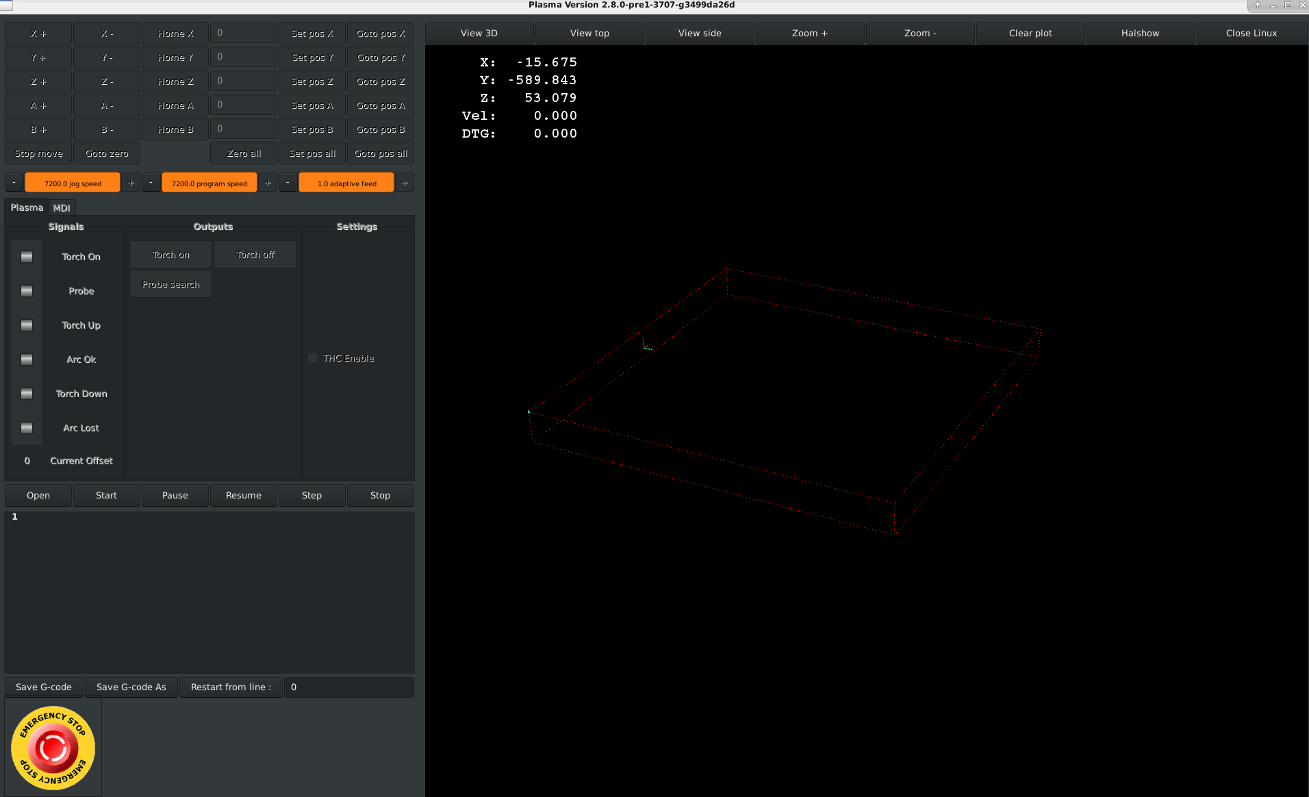

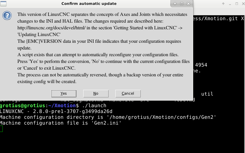

I just did a new install to try out.
I use a newer linuxcnc version. So i go again and try to select no update's
Attached terminal message :
LINUXCNC - 2.8.0-pre1-3707-g3499da26d
Machine configuration directory is '/home/grotius/Xmotion/configs/Gen2'
Machine configuration file is 'Gen2.ini'
Starting LinuxCNC...
Found file(REL): ./Plasma.hal
Note: Using POSIX realtime
config string '0 out'
Found file(REL): ./custom.hal
cant resolve path to 'python/toplevel.py'
Can't execute DISPLAY program ../../Xmotion
Interp ctor: cant instantiate Python plugin
Python plugin configure() failed, status = -5
task: 27 cycles, min=0.000014, max=0.010165, avg=0.004653, 0 latency excursions (> 10x expected cycle time of 0.010000s)
/home/grotius/linuxcnc_debug.txt
and
/home/grotius/linuxcnc_print.txt
as well as in the output of the shell command 'dmesg' and in the terminal
grotius@grotius:~/Xmotion$
If i choose not to update i get :
check_config: ERROR
Missing [KINS]KINEMATICS=
Missing [KINS]JOINTS=
check_config validation failed
and
Okey when i change in the Gen.ini :
[DISPLAY]
DISPLAY = Xmotion
to
[DISPLAY]
DISPLAY = grotius
Then i type : ./launch and it will startup an old grotius screen.
This old grotius screen startup's i must find out where that screen is living, see attachment.
But Travis application is starting up, so i am one step ahead.
