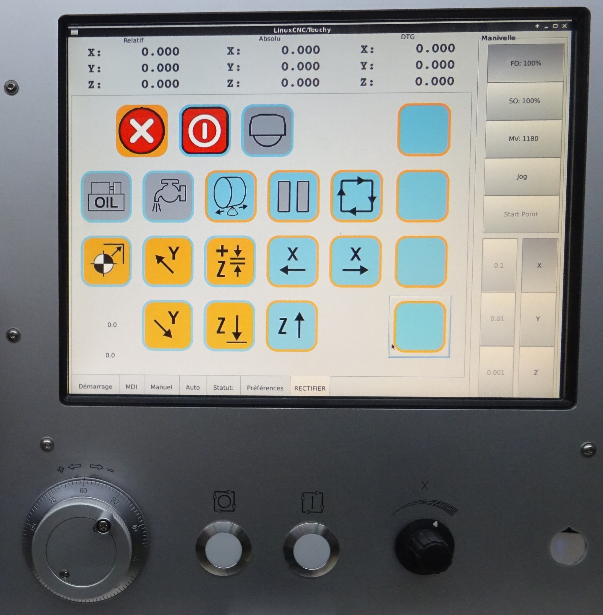

Thank you Chris, sorry, the actual thread here became a bit degenerated for only how to get Linuxcnc Widgets visible in designer.
I still understand very little of the manifold QTvcp possibilities at the moment, I should continue to ask for details in individual threads, may be?
It would be desirable to load and save parameters from and to the Linuxcnc.var File
then set actual parameters for use in grinding macro may be in a Qtvcp tab in Touchy
may be parallel use of a extra Qtvcp CamView window
jog with relevant joint to position behind workpiece, press yellow button "teach in behind workpiece"
jog with relevant joint to position ahead of workpiece, press yellow button "teach in ahead of workpiece"
jog with relevant joint to position over top of workpiece, press yellow button "teach in secure top of workpiece"
input grinding allowance some way, press yellow button "teach in grinding allowance of workpiece"
and so on for all needed parameters
then with relevant macro press start button for grinding

Sorry I missed this - am working out of town.
You could start a new thread if u like or continue here.
Reading and writing the var file is certainly possible - I wish there was a better way as it's really 'working behind linuxcnc's back' and that always feels dangerous to me, but we do it in some widgets already.
Qtvcp is embedable - I am a little Leary about keypress fowarding - do you use keyboard for jogging or abort etc?
The rest seems to be reasonably possible with some programming.
Chris M
