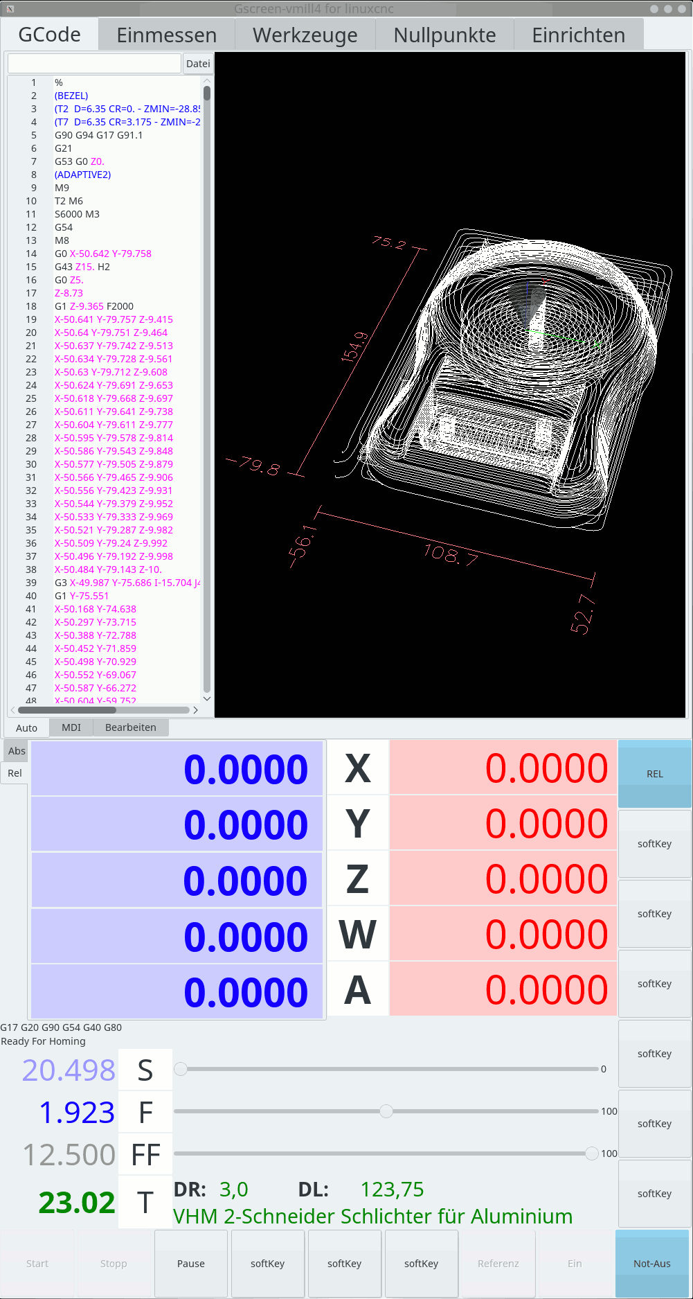

I finally got a working setup for gscreen and glade and I'm on the way to build my ideas.
Primary goal is to create a UI, which allows me to recognize machine state from the distance (3-5m), so I use bigger font sizes and colors to separate different meanings.
The small notebooktabs are to ease my work. They will be hidden in later version - and I switch tabs by external signals.
What I don't like at all are the override controls.
I would like to use a progressbar instead - but as soon as I enable different coloring, I get some errors like:

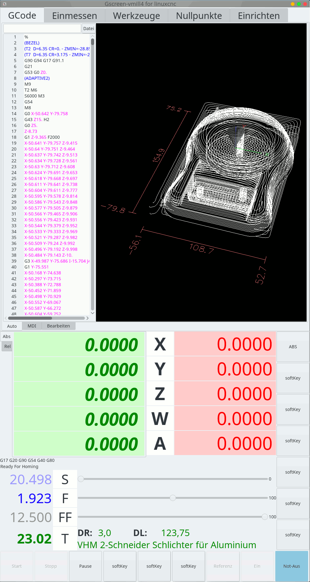

... and here is a view with the position notebook flipped to absolute positions:

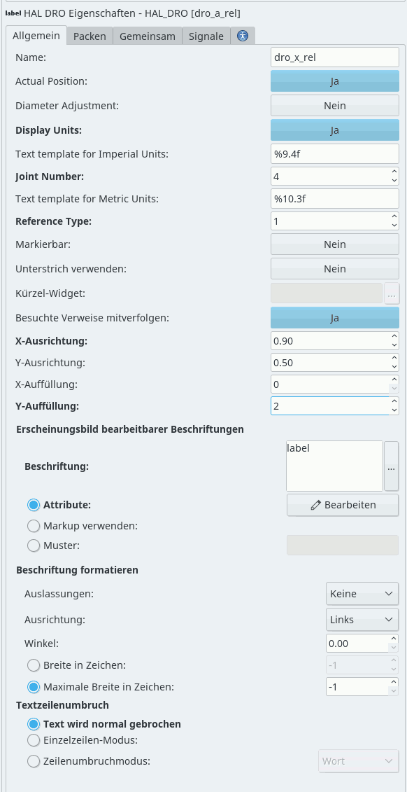

In my ini-file I've set LINEAR_UNITS to mm in section [TRAJ] but the dro widgets seem to not care about that setting. How can I get the dro to use mm-templates?

15 Jun 2019 19:24 #137005 by cmorley
You can set the display type in the GLADE editor or the python handler file
[widget name].set_property("display_units_mm",True)

16 Jun 2019 04:39 - 16 Jun 2019 05:29 #137020 by Reinhard
@pl7i92
Servus! - Schön jemand in der Nähe zu wissen :)
Das Traj ist nur für die maschine Gscreen hat unter Einrichten eine eigene UNIT angabe für den DRO
Ja, dumm von mir anzunehmen, dass der Designer das auslesen würde :(
The dro property prompt is a bit misleading (at least it was to me):
I understood "Display Units" in the sense of "should units be shown together with the numbers" and selected "no".
May be, you'd like to change togglebuttons text to "metric/imperial" or - in case the togglebutton can display yes/no only, change the prompt to "use metric units".

display_units : GLADE is a bit limiting on how the editor renders data types: BOOL data is always a toggle button. yes we should change the tittle or pop up text.
