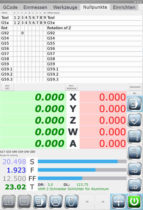

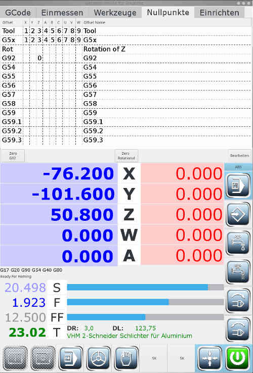

24 Jun 2019 05:59 #137703
by Reinhard
Replied by Reinhard on topic GScreen and some understanding gap of hal-widgets
With the help of some mdi commands I was able to get different numbers on absolute and relative dro.
Blue dros are the relative positions and green the absolute positions
What I don't understand:
both images are taken right after start of linuxcnc, powering on and home all axis.
Shouldn't the fixture-table show the difference between relative and absolute position in some line?
I looked at offset-widget.py and there's a periodic call, that should update the table content - at least at my understanding.
What am I missing here?

24 Jun 2019 06:06 #137704
Replied by cmorley on topic GScreen and some understanding gap of hal-widgets
My guess is the tooltable is not initialized with the toolfile path.
try adding:
self.gscreen.init_tooleditor()
to the def initialize_widgets(self): function
Chris M
try adding:
Chris M

- Posts: 7368
- Thank you received: 2181
24 Jun 2019 07:03 #137710
Sorry i'm tired... the command should have been:
self.gscreen.init_offsetpage()
Chris M
Chris M
