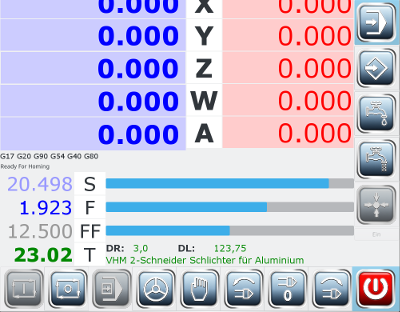

Hi Chris,
that's the most obvious way and I already tried that.
The only thing that happened: glade designer crashed
No matter, whether I create the image from the button by new image or create an image by myself ...
Then I tried to do it without designer and changed the xml manually ...
That way the button displays a placeholder for the icon, but does not show the icon.
The only way that works so far (discovered recently) is a code snippet from gladevcp iconview placed at initialize_widgets in my handler classThat shows a really ugly icon - which I would like to change naturally!
Then I wanted to know, where the icons come from and executed iconview.py
//Edith
Thank you for the pango hint!
image = gtk.Image()
image.set_from_stock(gtk.STOCK_GO_FORWARD, gtk.ICON_SIZE_LARGE_TOOLBAR)
self.widgets.button3.set_image(image)Then I wanted to know, where the icons come from and executed iconview.py
window = gtk.Window(gtk.WINDOW_TOPLEVEL)
gtk-stock: gtk-directory
File "./iconview.py", line 584, in <module>
main()
File "./iconview.py", line 572, in main
IFS = IconFileSelection()
File "./iconview.py", line 179, in __init__
self.dirIcon = self._get_icon("folder")
File "./iconview.py", line 266, in _get_icon
return theme.load_icon(name, self.icon_size, 0)
glib.GError: Symbol »gtk-directory« nicht im Thema vorhanden//Edith
Last edit: 17 Jun 2019 07:36 by Reinhard.
- Reinhard
- Posts: 508
- Thank you received: 94

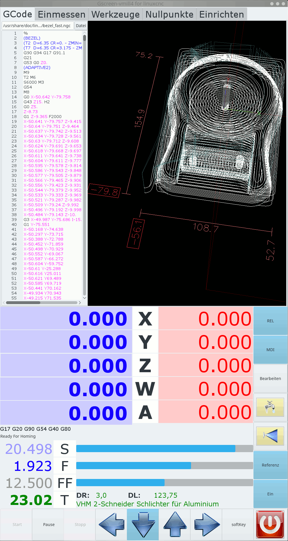

17 Jun 2019 13:20 - 17 Jun 2019 13:21 #137123
by Reinhard
Replied by Reinhard on topic GScreen and some understanding gap of hal-widgets
Hi Chris,
thanks a lot for the hint to pango and all of your help and patience!
That was the key to break through
Don't know why, but with designer I was not able to use an image - with or without button ...
From python it works like charming. Very nice.
With pango I was able to use TTF with pixelbased sizes and images on buttons that support transparency ...
I'm very happy with the current state. I could realize every visual requirement.
Now I can dedicate to work behind the scenes - wire signals and the like ...
Here's the current test-state:

Looks pretty darn good -I really like the button icons.
I think I would add a horizontal pane between the gocode display and the graphics, so you could adjust the split between them - sometimes it's nice to see all the gcode without scrolling.
Glad you are having success!
Chris M
