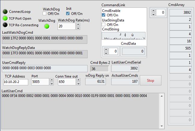

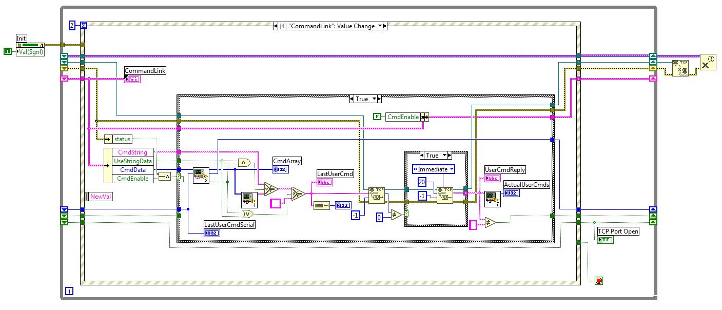

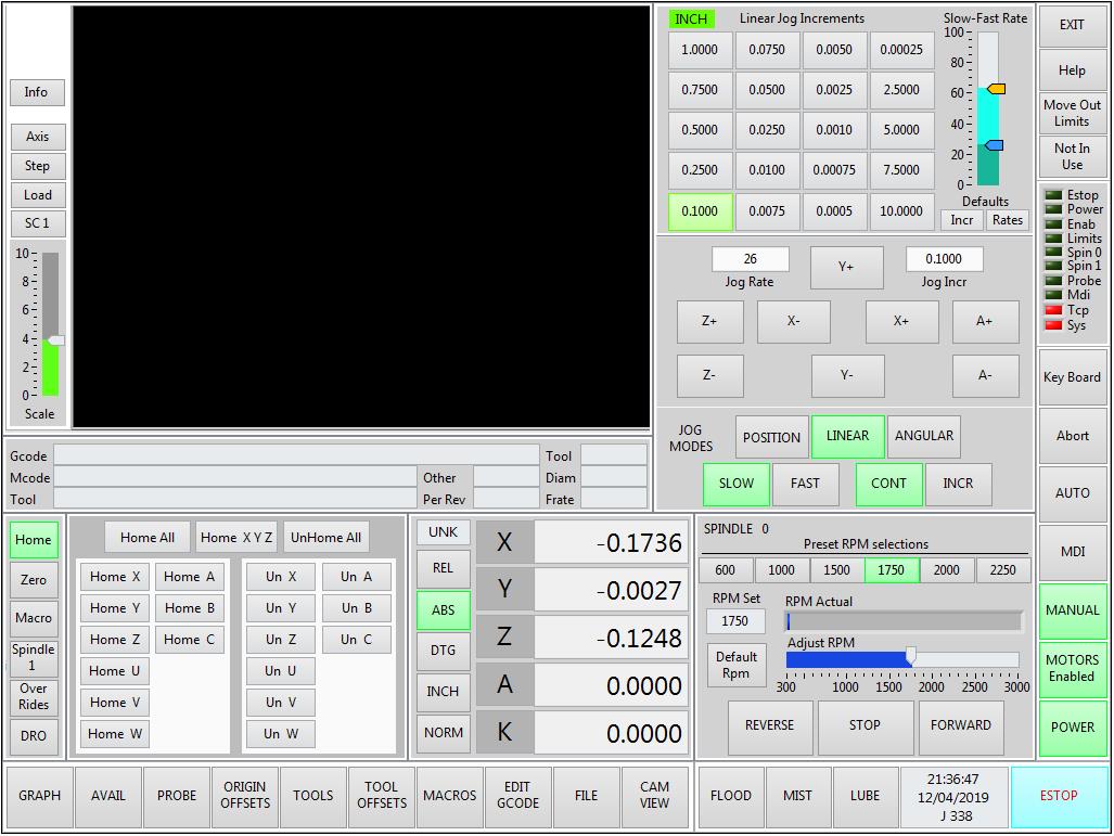

05 Dec 2019 06:46 - 05 Dec 2019 07:07 #152048
by auto-mation-assist
Replied by auto-mation-assist on topic Labview UI project for Linuxcnc
Its been a while since I worked on my project but its time to continue with the main parts. I have my test environment working with my modified Linuxcnc version 2.9 for testing with network access from port 5005 directly into nml. So far I have not found any issues with the work I did with Linuxcnc version 2.8 and migrating those to version 2.9.
Some additional items that I have also added for potential use later on are the Redis interface, USBio and Suttlexpress.
One of the main things that I need to work on is decoding more items contained in the 9196 Byte status string which would likely give the best performance but will take considerable effort. Part of the 9196 bytes is a header, with debug selection types at the end.
As a point of interest I have attached some pictures of part of the command data link Labview code and its current front panel that allows for monitoring of various data points. Also a overall view which will see some changes later on the top left side.
The K dro handles the linear scale on the knee of the mill.

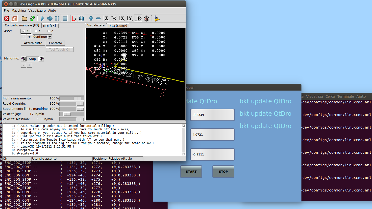

Very good thread .... but I haven't seen it until today when AndyPug told me about the user list.
After a few years I dusted off my whole C ++ interface project. Now while getting the status from nml is a relatively simple thing, I still haven't figured out how to send the commands to nml.
This problem derives from the fact that
1 - I am an amateur
2- I do not use the terminal as a debug for applications since '96
3- and this is the most serious thing, I have never properly studied the Lcnc files always referring to tomorrow. ..
now my doubt:
so I have to call the class RCS_CMD_CHANNEL or the function int emcFormat (type NMLTYPE, void * buffer, CMS * cms) using the TYPE of emc.hh ??
1 - I am an amateur
now my doubt:
