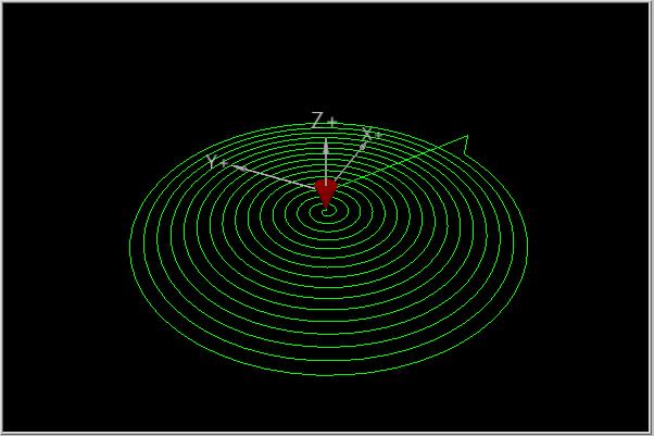

29 Sep 2019 19:15 - 29 Sep 2019 19:16 #146616 by auto-mation-assist
Replied by auto-mation-assist on topic Labview UI project for Linuxcnc
I have used the data from the Parser to generate a 3D picture that can be dragged by the mouse to give views from any angle. Not totally happy with it and since it can have its view angle changed it presents a problem with inserting text and have it remain in the desired location. This could likely be compensated for by just using preset views. I will work on this.
Here is a rendering of the code as I have it right now. Size of the display is 600x400.
Last edit: 29 Sep 2019 19:16 by auto-mation-assist.

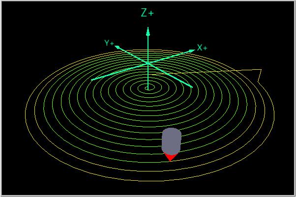

02 Oct 2019 04:50 #146854 by auto-mation-assist
Just a brief update on my progress for the Gcode preview display. I think I have it working well enough to make it useful. Still working on potentially putting a text display it which is not hard but making it stay in its place is a bit of a challenge when the angles are changed by mouse drags. Overlays are not allowed with a 3D picture. In a picture such as this 0 for each axis is in the exact center of a virtual box with each axis having a value range of 1 to -1 for its current coordinate.
It is good for now and with this working work can proceed on other items.
