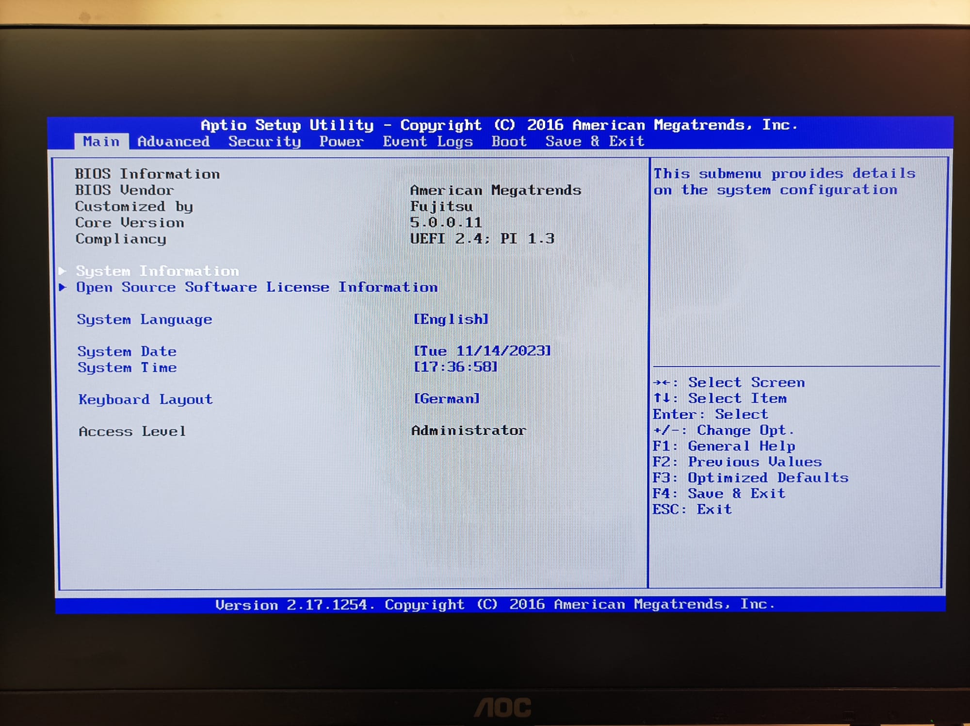

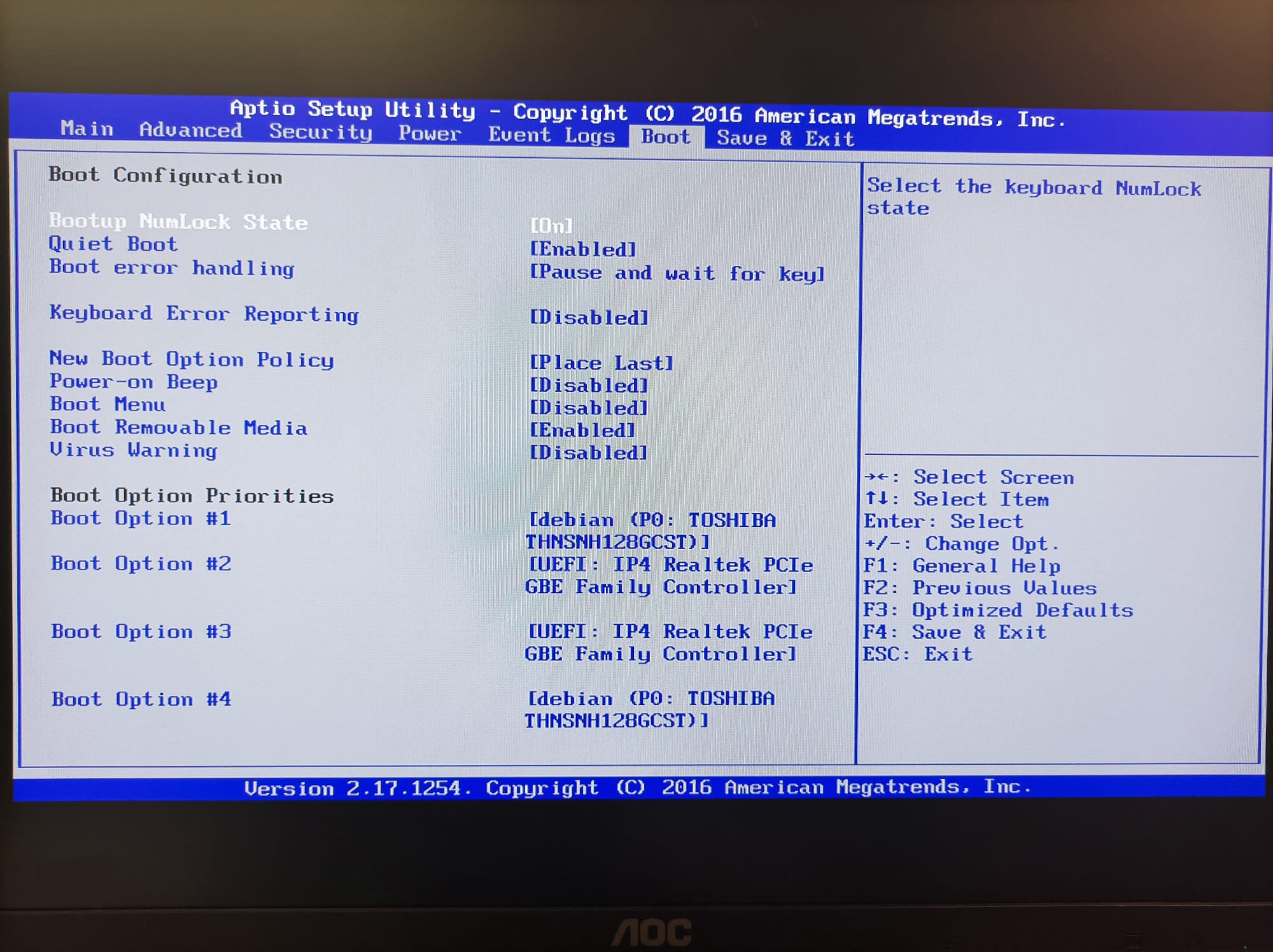

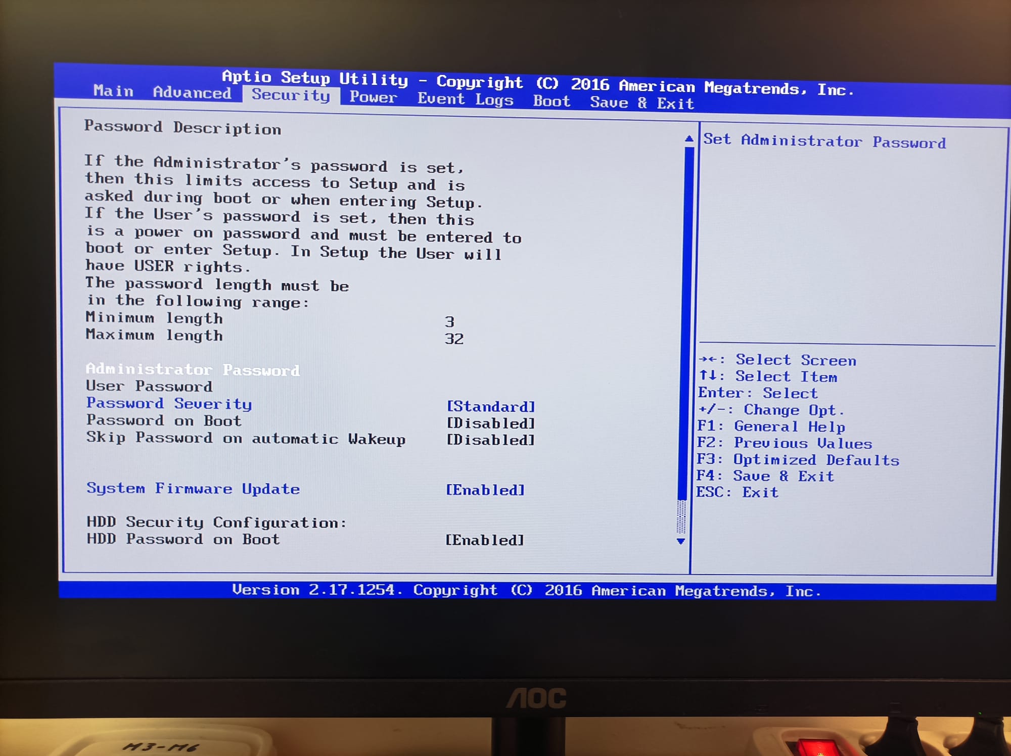

I'll see what I can find, I'll take photos of the bios, I don't know anything about it
Replied by Muecke on topic Unexpected realtime delay on task 0 with period 1000000

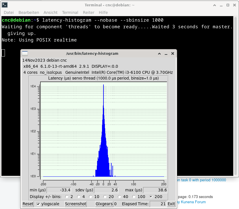

You should run the latency test without a base thread:
latency-histogram --nobase --sbinsize 1000
YOU mean stuff in the bios?I would guess you still have some power management ( EIST, cstates > C1 , Turbo mode etc ) enabled

Basically you need to disable everything on the CPU configuration page
( leave the active cores as all and C states as C1 max)

14 Nov 2023 19:11 #285409
by Muecke
- Posts: 18117
- Thank you received: 5335
14 Nov 2023 19:15 - 14 Nov 2023 19:16 #285410
Replied by PCW on topic Unexpected realtime delay on task 0 with period 1000000
Much better, now try LinuxCNC...

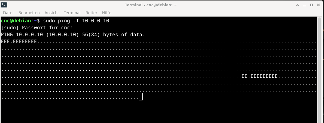

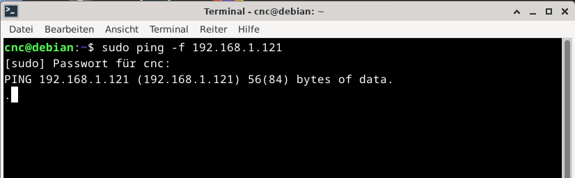

The new dug
$ ping 10.0.0.10
How can I stop this?
$ sudo ping -f 10.0.0.10
I can't get this cancelled
$ ping 192.168.1.121
$sudo ping -f 192.168.1.121
it remains one .

#GRUB_INIT_TUNE="480 440 1"$ ping 10.0.0.10
$ ping 10.0.0.10
PING 10.0.0.10 (10.0.0.10) 56(84) bytes of data.
From 62.155.245.22 icmp_seq=1 Destination Net Unreachable
From 62.155.245.22 icmp_seq=2 Destination Net Unreachable
From 62.155.245.22 icmp_seq=3 Destination Net Unreachable
From 62.155.245.22 icmp_seq=4 Destination Net Unreachable
From 62.155.245.22 icmp_seq=5 Destination Net Unreachable
...$ sudo ping -f 10.0.0.10

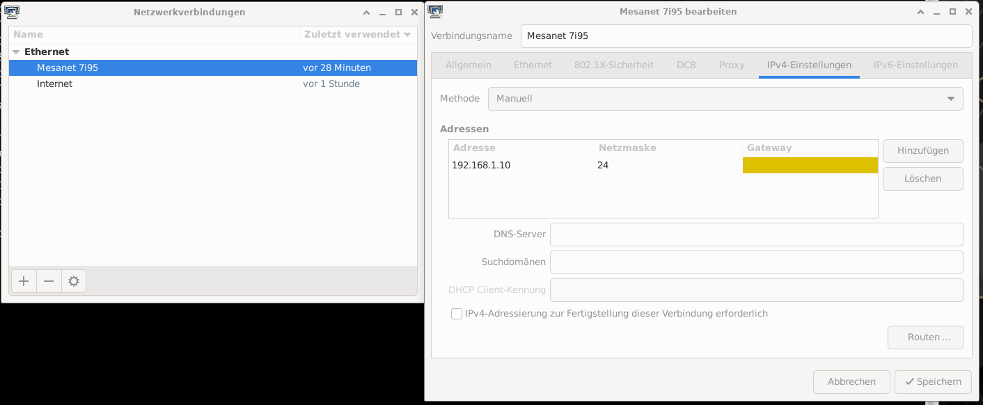

- Posts: 18117
14 Nov 2023 20:20 #285416
Likely a network setup error.
What does
ip a
report?
Also it is suggested to use the Mesa card at 10.10.10.10 not 192.168.1.121 as
the 192 range may overlap local DHCP assigned addresses used for normal networking.
If the Mesa card is set for 10.10.10.10, you need to set the host to an address
in the same range, 10.10.10.100 suggested.
You cancel a ping command with control C
What does
ip a
report?

14 Nov 2023 20:25 #285417
by Muecke
$ ip a
Ok, I'll have to look into the IP 10.10.10.10. Jumpers must be moved on the card for this.
Do I then only have to enter 10.10.10.10 for the address in the network configuration?
