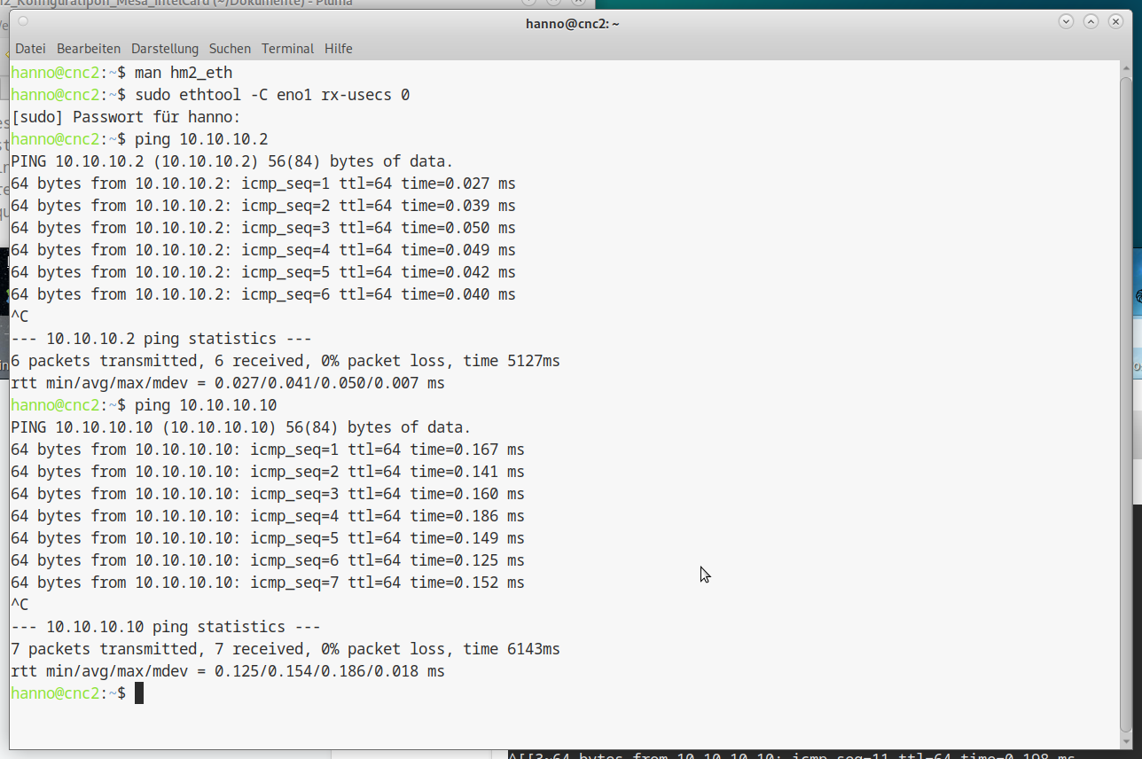

" IRQ coalescing is not disabled." How can I do that?
- Posts: 18105
- Thank you received: 5328
31 Jul 2024 20:39 #306566
Replied by PCW on topic Latency Test OK, dennoch Fehlermeldung
man hm2_eth
for instructions for doing this permanently
to test temporarily:
sudo ethtool -C eno1 rx-usecs 0
The following user(s) said Thank You: Muftijaja

31 Jul 2024 21:43 - 31 Jul 2024 21:52 #306570
by Muftijaja
Replied by Muftijaja on topic Latency Test OK, dennoch Fehlermeldung
Last edit: 31 Jul 2024 21:52 by Muftijaja.
- Posts: 18105
31 Jul 2024 22:11 #306571
As described in the hm2_eth man page, it involves adding the appropriate text
to the /etc/network/interfaces file, in your case, adding something like:
auto eno1
iface eno1 inet static
address 10.10.10.2
hardware-irq-coalesce-rx-usecs 0
You need to run the editor as root (with sudo) to edit this file
After editing the file its probably best to re-boot and then check if the
setting works with:
ethtool -c en01
auto eno1
address 10.10.10.2
setting works with:
ethtool -c en01

Hmm I tried both, changed priorities eno1 to 1 and auto/enp2 to 0 - no effect.
Then I changed the position of the lines in /etc/network/interfaces - no effect at all.
On what reason ever, the network definitions are faulty.
WTF is going on there?
