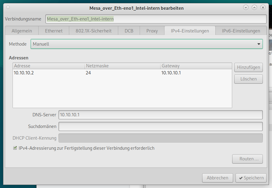

OK, I switched ipv6 off in both networks, no effect. And I added the adress 10.10.10.2/24 in the four lines in etc/network/interfaces
Same issue as before. I'm asking me why there is this altname fault in ip a. I definitely have the right definitions in the two network settings, eno1 and eth2

You will most probably have to reinstall everything.
In the networking HOWTO it is clearly stated to use that OR the /etc/network method, NEVER both!
You are using both. It also states to edit the existing wired connection, you did not, you added another one to the same interface.
Now you have 3 networks with the 2 of the same IP on a single interface, as you did not edit the existing one, but you added another one.
Try deleting every wired connection from the network manager and reboot.
If this does not work, reinstalling everything is the fastest way to get up and running, trying to fix this mess takes much longer.

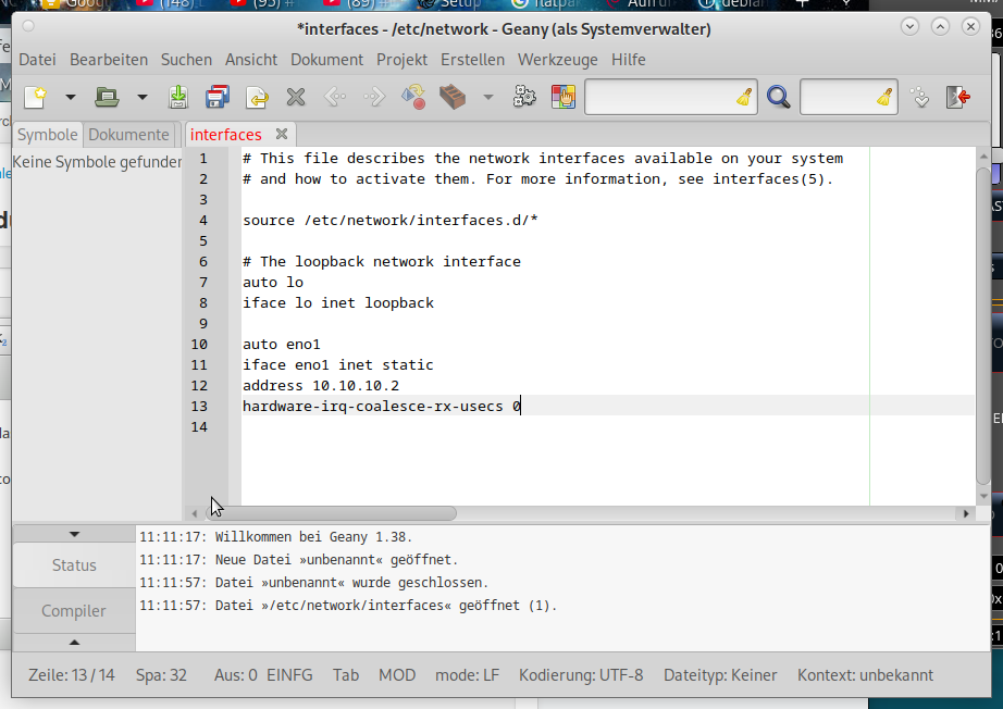

That's fine, but the wrong card was configured. I suspect that the Intelcard is calling enp2s0. Try modifying the file this way.Hello PCW,
thank you for your answers! (sorry for delay, I was very busy the last days and couldn't do anything at my machine.)
I tried the lines in /etc/network/interfaces file and after reboot my internal Intel network was disabled. Just auto internet with RLT8111 is possible. The file is as follows:
Well, internet network is ok. What is the faulty setting here?
auto enp2s0
iface enp2s0 inet static
address 10.10.10.2
hardware-irq-coalesce-rx-usecs 0
auto eno1
iface eno1 inet dhcp

@Chris@cnc - i changed the network/interfaces to your suggestion and after reboot I dont have any connection no more.
Is that allright? Do I have to reconfigure both connections as before? How do I find out which name is what card? I want to have the internal intel card for MEsa and the RTL8111 for Internet. Cables are sitting ok for that config.
